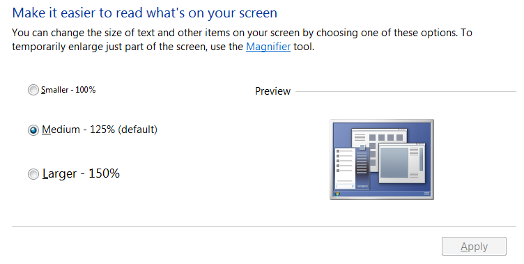

OK - Control Panel > Appearance and Personalization > Display says that 125% is default:
I’ll change this to 100% and see if that solves that one…
EDIT:
All good at 100% - but not sure if that is the way it should be (-;

Seems like Windows 10 sets scaling by default to 125% if you have an HD (1920) screen… At least it did on mine.
–Mitch
FWIW, this is on Win7.
But thanks for getting back to this - I’m still at 100% and perhaps I should put it back to default 125%.
