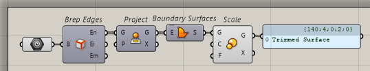

I’m having some problems with my tolerances. I need to scale my GH geometry (in meters) by a 1000 because Revit work in mm and I’m using RiR to send stuff over to Revit. But once I scale my trimmed surface it becomes invalid.
-The object is 80meters from our 0,0,0 UCS
-I tried setting my my rhino tolerance differently. Everything between 1 and 0.001 (mm)
-I noticed the trimmed surface becomes invalid after I scale it more then 214 times.
-Once I Untrim the surface, scaling works perfectly. So I assume it has to do with the tolerances of trimming.
-It work If I Untrim scale, and scale the curve from the Trim separately and trim the surface after the scaling (see screenshot)
Does anyone have any suggestion how to fix this issue?

That, too, is dependent on the Rhino document tolerances - with that set to 0.001, it doesn’t work:
At any rate, is that input object supposed to be planar? It is oddly not quite planar as it is now.
It also seems unnecessarily complex:
Projecting the edges to make them planar, creating a new surface from those, and scaling seems to work fine:

The surface is indeed complex, but the level of detail and accuracy of this floor is necessary for the design we’re making. Therefor making it planar cannot help. But indeed, scaling the planar srf indeed works.
@inno Yes that does work! But I can’t seem to understand how the zero magnitude transformation is fixing this issue :face_with_monocle: What exactly changed the surface?
