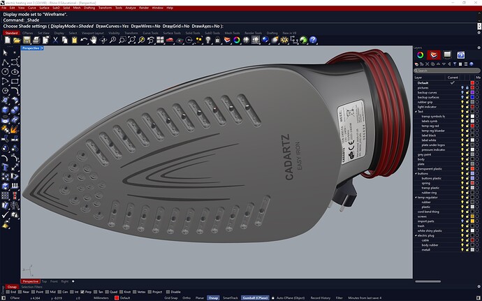

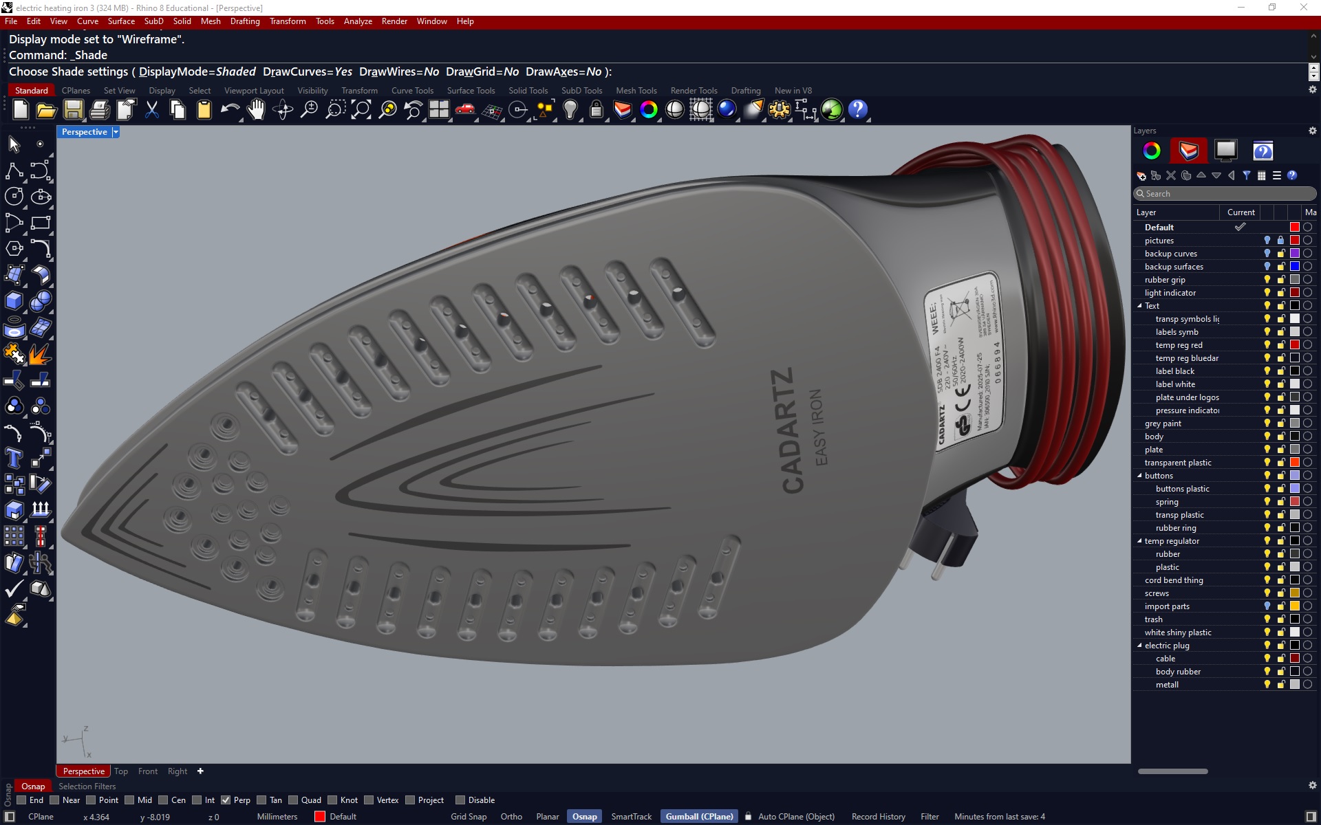

Made my third electric heating iron but this time i recorded the whole thing.
some renders
 ![electric heating iron 3 render.117](https://global.discourse-cdn.com/mcneel/uploads/default/original/4X/6/0/8/6080d42a7664bc80c11293bfc825862b48f80e8f.jpeg)
 ![electric heating iron 3 render.118](https://global.discourse-cdn.com/mcneel/uploads/default/original/4X/8/2/b/82bf1214629a97a0b113beeeb6421c35a1064600.jpeg)
 ![electric heating iron 3 render.119](https://global.discourse-cdn.com/mcneel/uploads/default/original/4X/a/b/5/ab50b13256d56ed0fe2467142c34aac243e0aa94.jpeg)
 ![electric heating iron 3 render.120](https://global.discourse-cdn.com/mcneel/uploads/default/original/4X/1/1/e/11e5deb89802a168240f5d3438182d2460a9ca8e.jpeg)
rhino shots
 ![1](https://global.discourse-cdn.com/mcneel/uploads/default/original/4X/d/b/d/dbd651a8f6d5cd2bc7a59d964e128ec9966170cf.jpeg)
 ![3](https://global.discourse-cdn.com/mcneel/uploads/default/original/4X/6/f/4/6f4b6395e5802b44823e7ad9bbca94d55205c9f1.jpeg)
 ![4](https://global.discourse-cdn.com/mcneel/uploads/default/original/4X/9/4/3/943cd0319fedbfae16da69b45130f4f713c4c7c0.jpeg)
 ![5](https://global.discourse-cdn.com/mcneel/uploads/default/original/4X/f/a/d/fad769eaa3d55549d0a89361a71c24e3a7893730.jpeg)
 ![6](https://global.discourse-cdn.com/mcneel/uploads/default/original/4X/a/5/7/a57e9f72be815c2874be3ab5639f66c28ae62c9c.jpeg)
 ![2](https://global.discourse-cdn.com/mcneel/uploads/default/original/4X/3/2/a/32aad08b6d78b3775ca68ecdf884fdbf5232603a.jpeg)
The video, let me know if i can make the videos any better since im just starting out making these, any feedback is appreciated enjoy.
