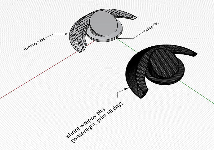

ok, I’ll leave you to it, I’ll just mention you can make nurbs parts, just smash them in proximity to the existing mesh parts and then mesh boolean for 3d printing or shrinkwrap to get parts that will work great for this type of work. I’ve done quite a bit of this and it’s a lovely workflow once you get a handle on how to work with meshes.
I love it because you don’t have to trim or boolean anything. It’s super fast, easy to change and very robust (plus you can shell it if you want- see my never fail shelling video on youtube)
@mention me if you want more details
