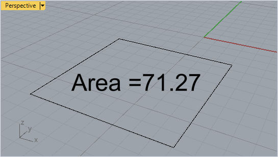

Dimension Leaders can do that if you go to File > Settings > Dimensions > Text and set the Text Alignment to “Horizontal to View”. But it will affect all other dimension text as well.
hey thats a good start, at least till this option as announce by pascal will ever manage it to the mac version. somehow i had the feeling this could be done so but i did not manage comprehending the alignment for this matters, thanks maxz!!!
