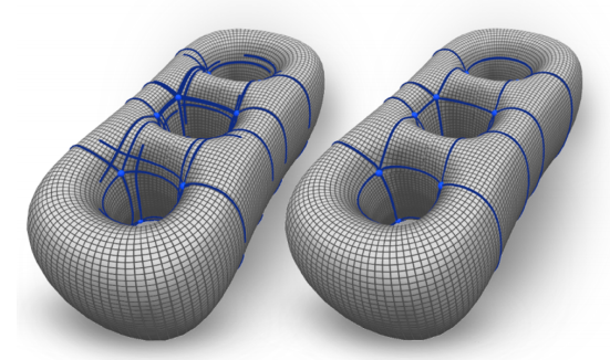

It should be possible or already doable to merge quads using singularities as frontier. Then theses merged quad could be transformed to SubD/Surface.
The closest I find is Kangaroo tools, Stripper that divide a mesh in strips.
https://www.researchgate.net/profile/Wei_Chen532/publication/329362712/figure/fig1/AS:699598603579392@1543808713205/A-quad-mesh-with-4-and-8-singularities-on-a-genus-2-surface-The-red-curves-are-the.ppm
It seems a good topolgy exercice to make such a tool.
I did once make a script to trace the separatrices out from the irregular vertices and split the mesh with these, but the issue is that in general the irregular vertices from the current quad remesher do not line up nicely, so the separatrices spiral around and split the mesh into many patches instead of the small number you would get if the mesh came from subdividing an initial coarse quad mesh.
