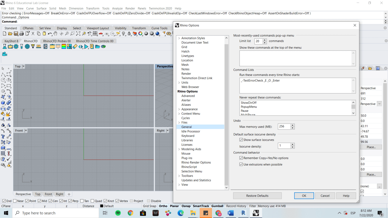

Hello! I’m trying to create a line in revit through Rhinoceros (I´m using Rhino WIP and Rhino.Inside):
The problem is that, everytime a make a line, point or so in the Rhino Window and try to “Set One Curve” in the Grasshopper window, I get this message:
And the results are that my Revit reminds empty:
I will appreciate your help!!
Thank you in advance.
To disable this dialog Copy the following line into clipboard and Paste it into the Rhino console.
_-TestErrorCheck _E _O _Enter

Every time I begin Rhino and try to make a command, I see that error and I have to paste _-TestErrorCheck _E _O _Enter all the time.
Is there a solution to get rid of that window once and for all?

Anyway, you can add this command here to run it every time Rhino starts.

I did what you sujected and the error is still showing.
Have you restarted Rhino.Inside Revit?
I didn’t mention it before, but you need to restar it in order this command runs at least once on the next start.
