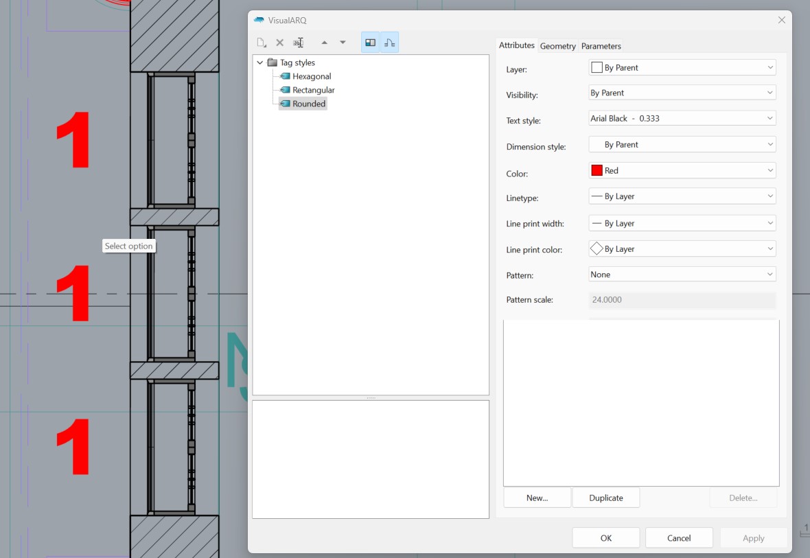

I can see that the text size of your tag style is too big. Changing it to a smaller value, the tag seems to show up correctly. I also see the tag boundary. Can you try it?
Thanks Francesc, but it’s not working here:
Could it have something to do with my units, which are set to feet?
