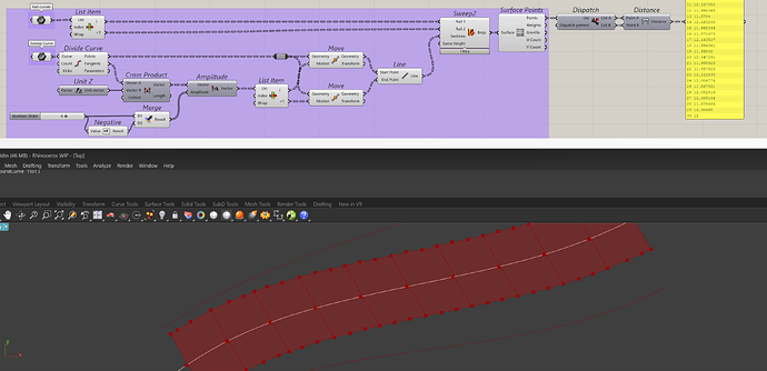

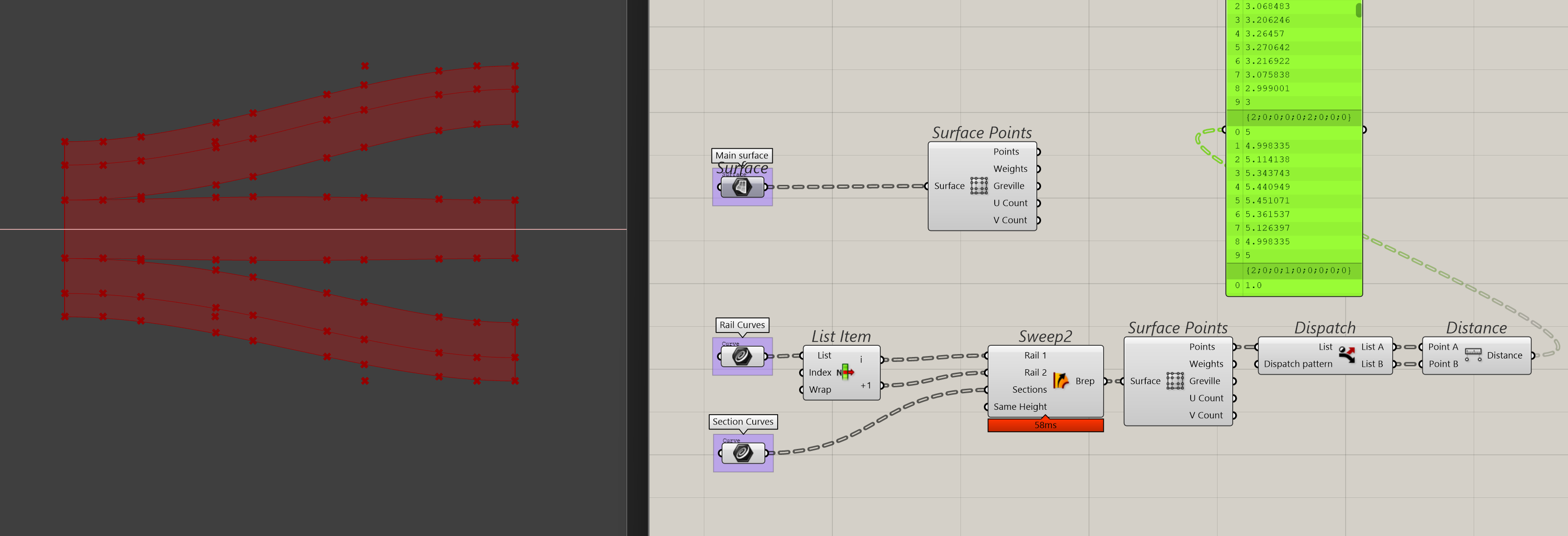

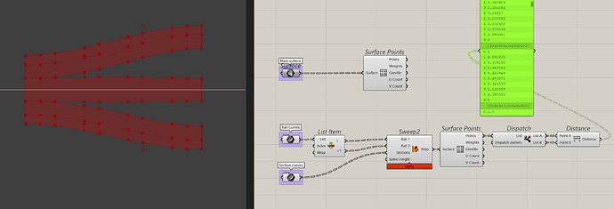

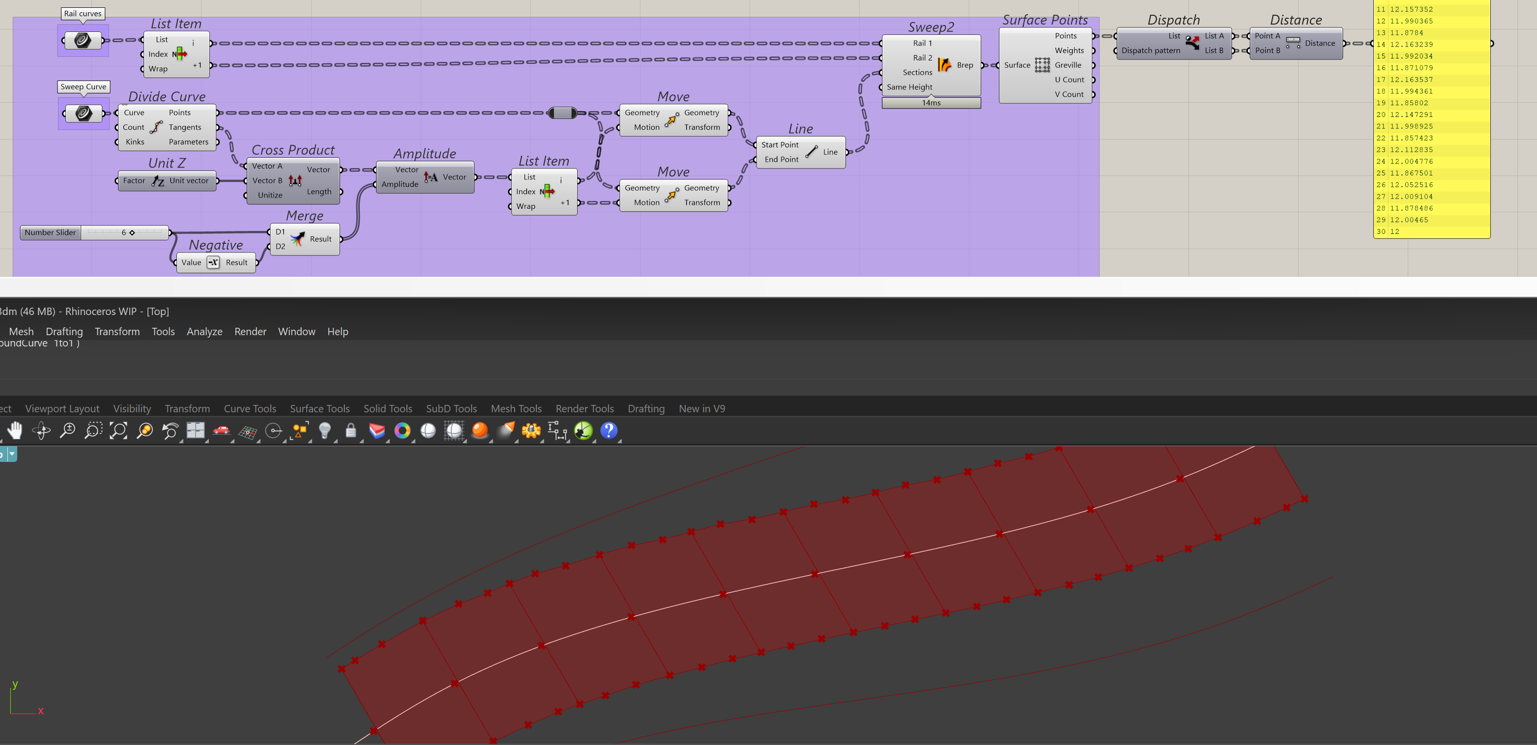

With the absence of a roadlike function for Sweep2, I’m looking to create additional sections at the surface’s CVs to help guide the sweep. The problem I’m running into is that I use the edges of the street as rails, but even when the section profiles at either end of the sweep are equal in length, it tends to diverge a lot around the center as indicated by the change in distance between the first (first section) and last pair of points (last section) in the list.
 ![image](https://global.discourse-cdn.com/mcneel/uploads/default/original/4X/3/0/a/30ad45a20ec5609adcdf1515dd8541790a3e4e89.png)
 ![image](https://global.discourse-cdn.com/mcneel/uploads/default/original/4X/0/a/3/0a3129a6ee8fc8e985b83b70dff9db525a9498f5.png)
Does anyone have any ideas how to mitigate this whilst not adding to the surface’s complexity?
[Sweep2 Roadlike.gh](https://discourse.mcneel.com/uploads/short-url/kNJZQOq6UO4i8wnqiZG7t3ZVX0N.gh) (91.9 KB)
E: Updated the file to include more data.

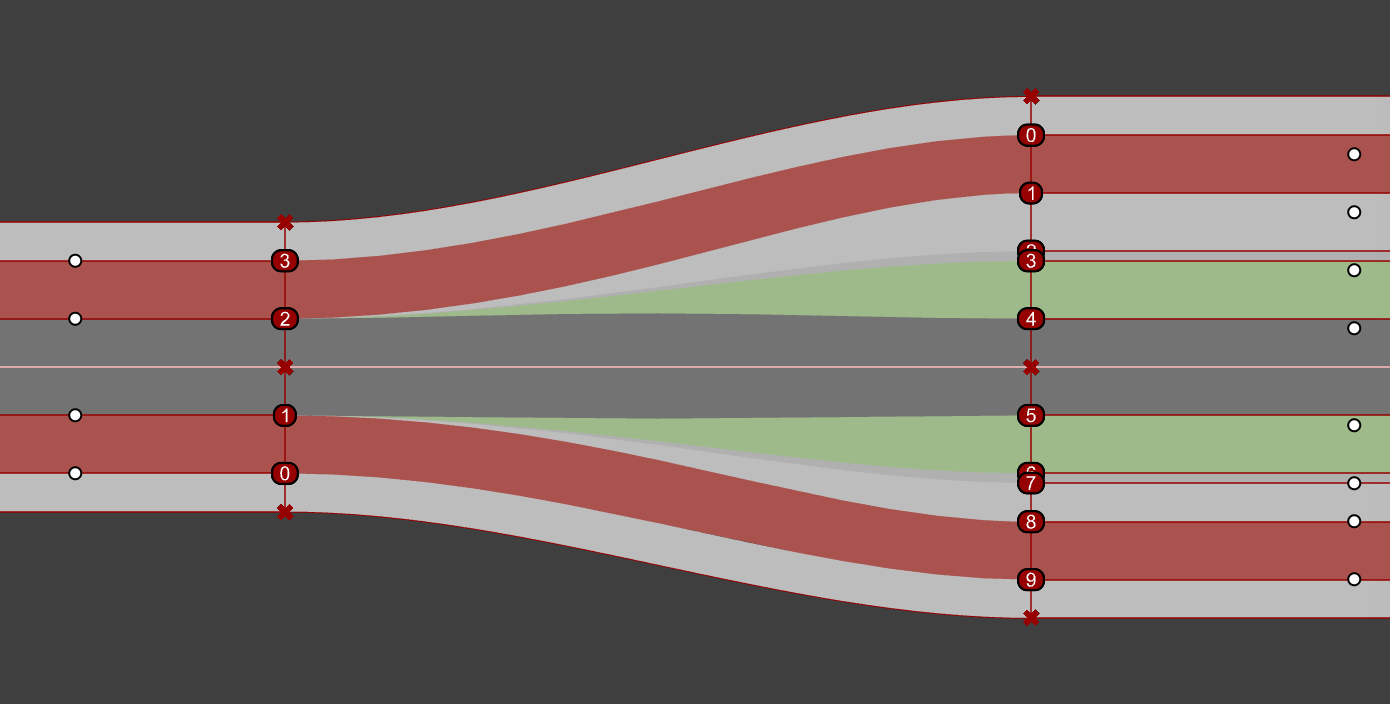

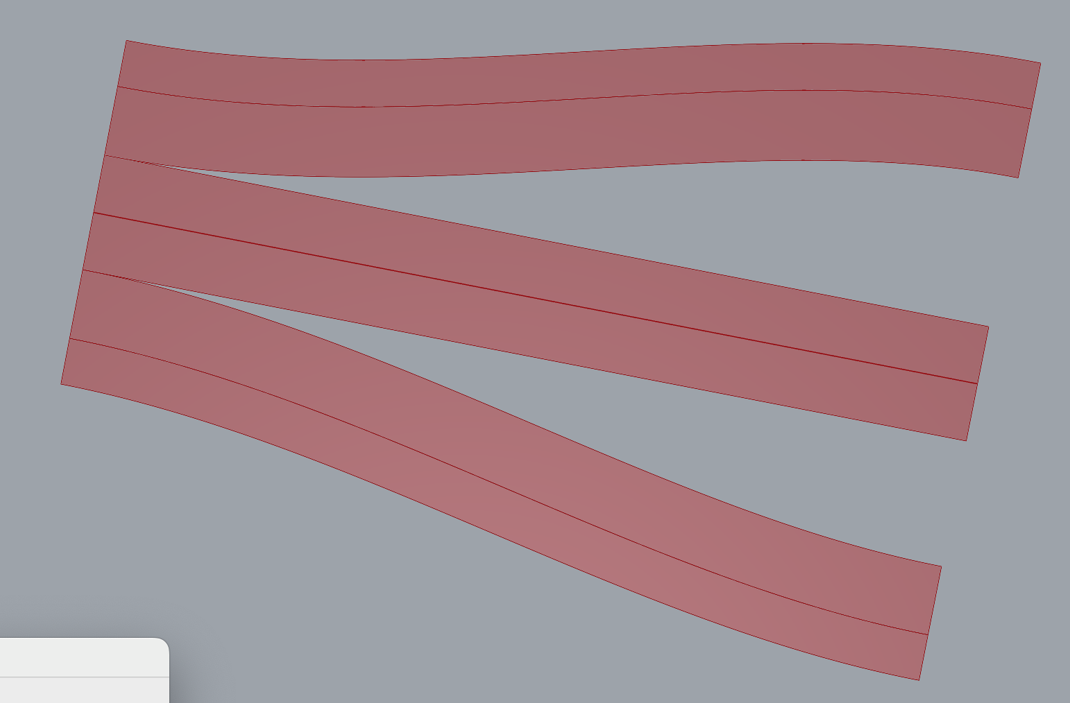

The often suggested method to use additional sections has the following result:
 ![image](https://global.discourse-cdn.com/mcneel/uploads/default/original/4X/7/5/2/75266ca88934a6bd8e779c0388623a6ffc41e4aa.png)
The surface is all wavy when I use both rails on either side (which I need to conform the swept surface to the street edges). You can see this numerically in the panel with the section distances.
[Sweep2 Roadlike.gh](https://discourse.mcneel.com/uploads/short-url/lkiwP7GTo7nSoJFUU0W9U3bnUwa.gh) (89.5 KB)

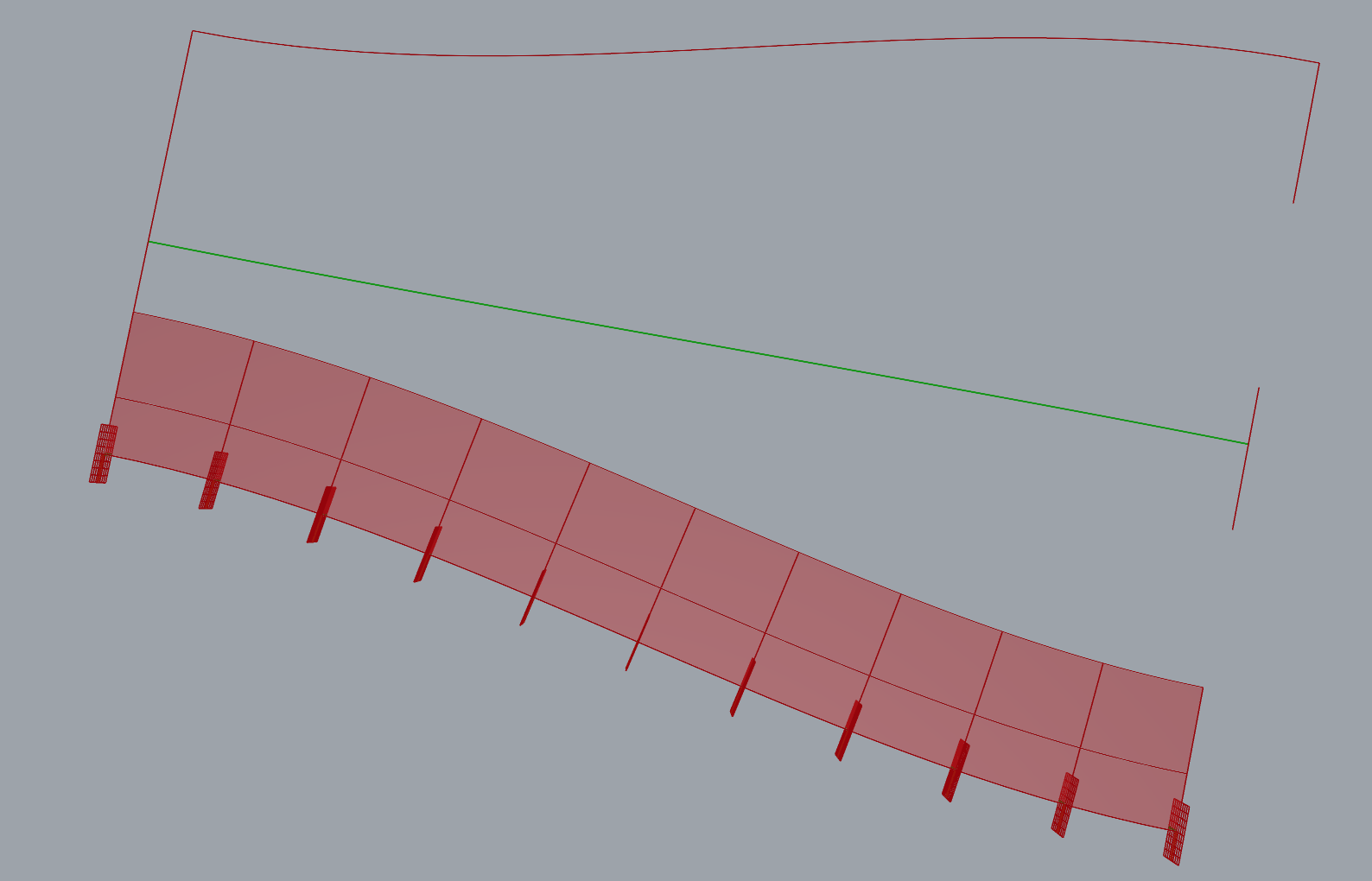

It is possible to do a crude change of rails depending on which one is closest, but that doesn’t solve cases where the swept rails cross the centre:
 ![image](https://global.discourse-cdn.com/mcneel/uploads/default/original/4X/e/e/c/eec576a1edccf0d155dd0e769e18e453828f32f8.png)

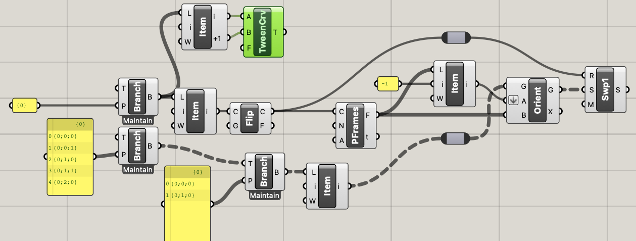

Dear Intuos,
It took me some time to understand what you are working on. For answers on this forum, best is to keep it simple. The faster you get an answer.
-For now, first I did was bring all your data back to one rail + two sections, together 1 road.
The problem with your approach (2 rails + all sections) is, that you force grasshopper to treat all these sections as parallels to each-other, giving strange effects in the curved parts.
 ![Canvas at 14;09;50](https://global.discourse-cdn.com/mcneel/uploads/default/original/4X/4/a/f/4af9b8dd735d59a3604c544ab195baa292ac7751.png)
- To solve this, the sections have to follow the curve of the rail. This is done by:
- going back to sweep1 + one rail
- divide the rail in n sections and place frames/planes Perp Frames
- Then use Orient to get your sections to all planes.
Now they are perpendicular to your rail, and have same length.
Sweep1 does the job.
 ![Scherm­afbeelding 2025-08-23 om 14.09.04](https://global.discourse-cdn.com/mcneel/uploads/default/original/4X/4/d/9/4d92239b75cc7ab82beab02a9724d0a820549a51.png)
Repeat for the other rail. (if you work correctly with the branches and lists, you could use the same components for that)
For the middle one, you need a new rail.
I would make that with Tween Curve (See the example I did. Also when the two rails you start with, are NOT symmetric, Tween Curve will create something in the middle.
Then you may use same logic as above (and could also be done with same components).
[Sweep2 RoadlikeEW.gh](https://discourse.mcneel.com/uploads/short-url/aU2sH5jEqjeazrs3mZynUob5Nk4.gh) (19.3 KB)
OK. Something to study and extend for you. Have fun , regards, Eef

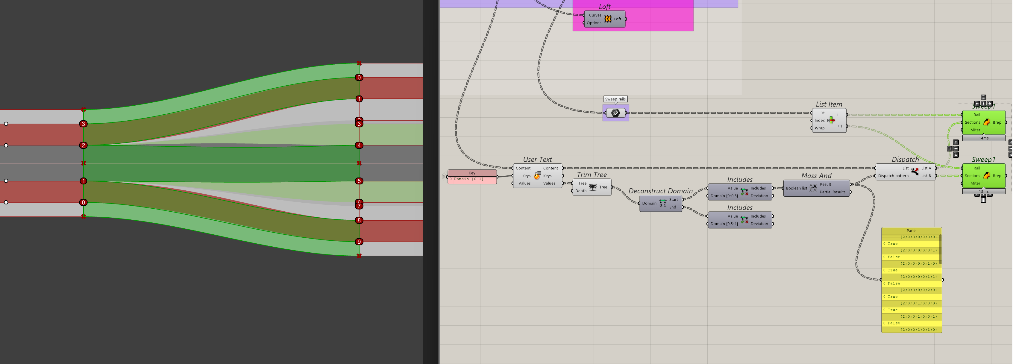

After a bit more playing, this is what I got to:
 ![Scherm­afbeelding 2025-08-23 om 15.01.48](https://global.discourse-cdn.com/mcneel/uploads/default/original/4X/c/a/0/ca0f7264996c490cac01b23e682e7c5f63e9c24b.png)
What is changed:
- 3 roads and not 1 🙂
- For sweep\_1 those perpframes are not needed. I compared them, no difference to be seen. So kicked them out.
- The middle one, was a bit strange, this is because these two sections may look parallel (as a rectangle), but weren a bit shifted. So I created a new rail with Middle Curve .
(I suppose for a road, that is not acceptable, if so, you need a new rail there (with a tiny S-curve in it). 🙂
 ![Canvas at 15;02;10](https://global.discourse-cdn.com/mcneel/uploads/default/original/4X/2/6/b/26b0ba8af9eab799ce9cae68c32c923c42f20841.png)
[Sweep2 RoadlikeEW2.gh](https://discourse.mcneel.com/uploads/short-url/t13OlPsxJZA0mWc5ghMI6vGSvwz.gh) (17.6 KB)
