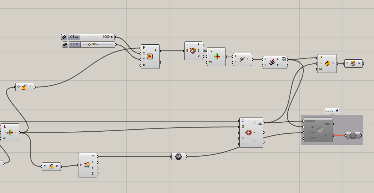

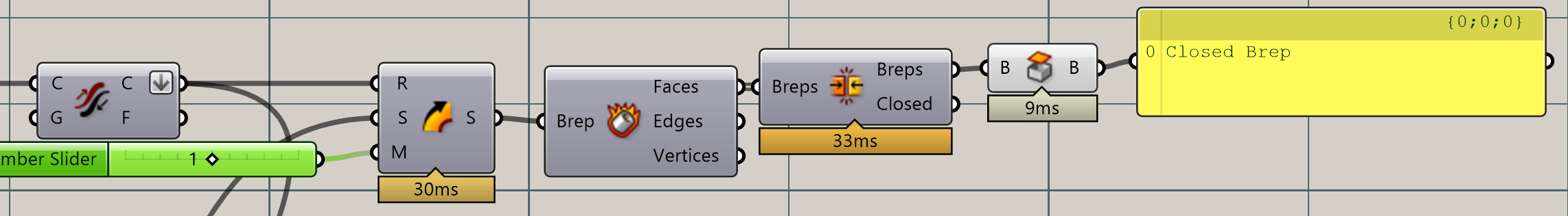

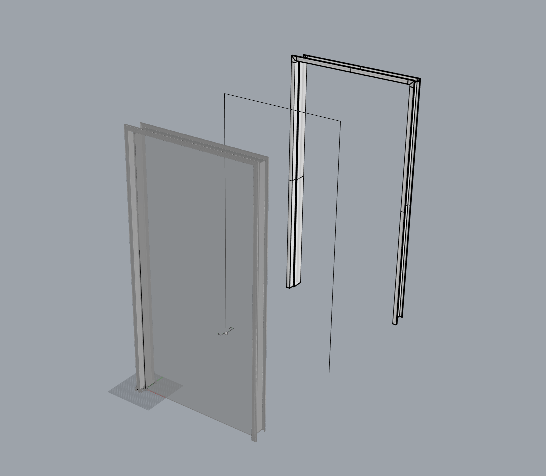

I would like to create a closed polysurface with Sweep1 or with a script. The goal is to sweep the cross section of a door frame along a polyline so that I get a door frame. If I use the ‘same’ geometry in Rhino, sweep manually and then use _Cap, I get the output I want. In Grasshopper it somehow does not work as desired, because it remains an open brep. Does anyone have any idea what the problem could be?

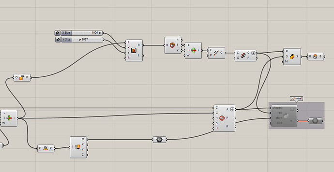

deconstruct brep, brep join does solve the problem.
a workaround?
