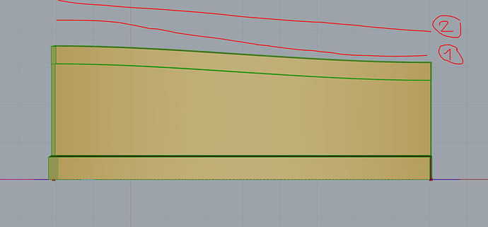

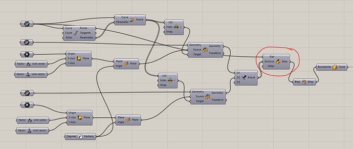

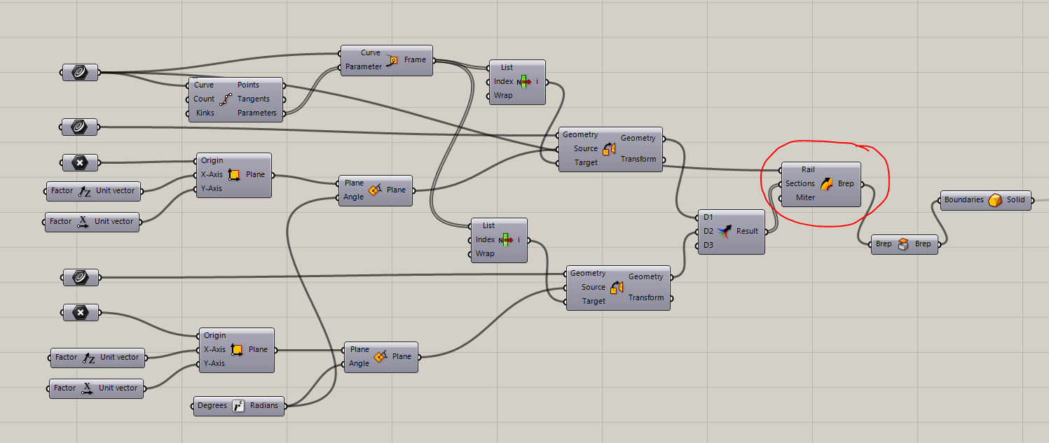

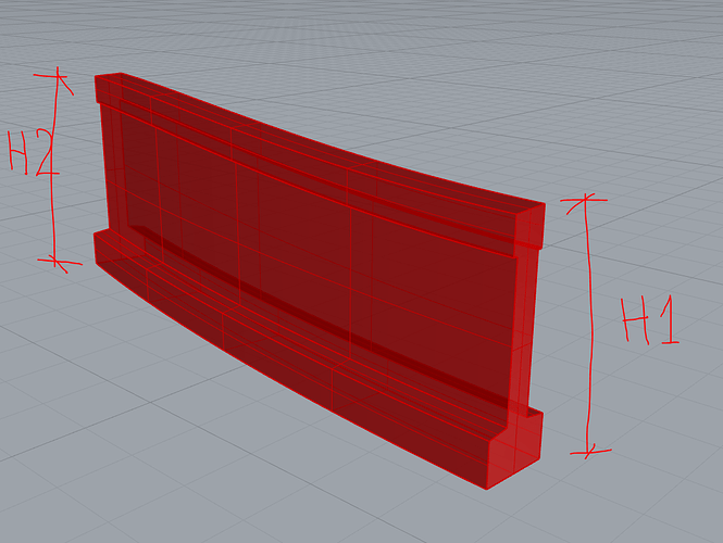

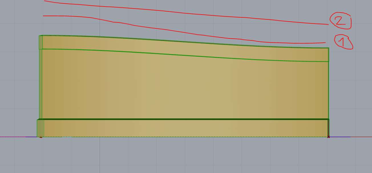

im new with Grasshopper, hope you can help. The problem is that i have to extrude variable crossection along curve. I got needed result except one small thing. How can i control the upper line, in this case i need straight line (marked number 2 on picture 3).

you need an upper rail just like how you noted “1” and “2”
you are using sweep 1
try sweep 2
