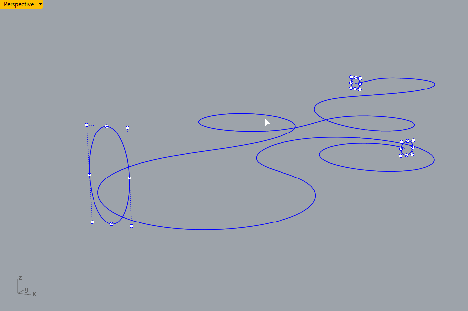

(Pascal Golay) #7
Hi Akash - the best would be not to have a polysurface at all - you can do this if you place all the section curves (circles and ellipses) with the orientation the same so that the points line up, like so:
And make sure to align the arrows in Sweep1 snapping to Knot,to hit the corresponding part of each curve.
self Intersecting sweep1_PG.3dm (668.5 KB)
And work from there.
