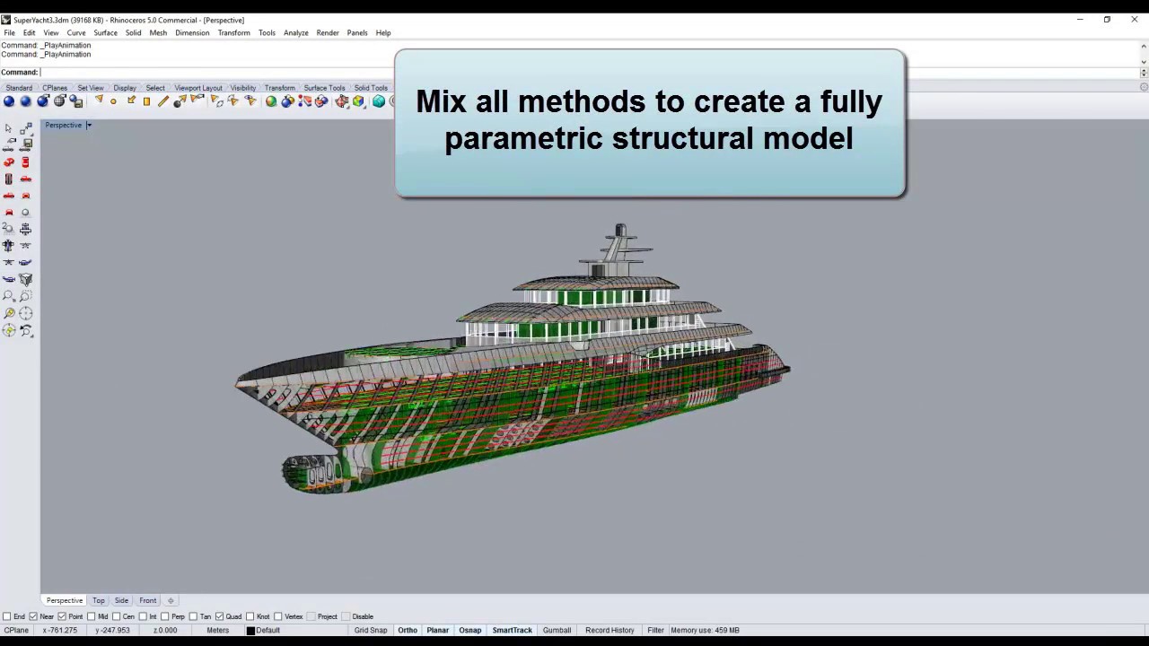

The problems associated with fair hull creation in Rhino are not trivial. I gave up with Rhino because of the difficulty of mouse clicking on planes at odd angles in 3D space. Thats where Grasshopper entered the picture
The other benefit of Grasshopper is that is a FULLY PARAMETRIC tool. Rhino interface is not.
But even better than that, in Grasshopper, every step from points to curves to surfaces to solid hulls is preserved for you to walk back through and rework at any point.
I struggled with a fair round bilge for months. I tried many approaches. Most of the suggestions you will find here are either simplistic, inadequate or require extensive fabrication time.
With GH, Rhino can turn out a hull that is better than any mouse clicked interface including Catia.

I have tried all the tools I could find and I keep coming back to Grasshoper. You can bend it to do modeling, create very accurate weight and CG analysis, Structural analysis and plug ins that can calculate bending loads etc.
You cn do all this in GH AND have access to all the pts. curves and surfaces for other operations. Im no knocking this product, but olike maxsurf, you gotta learn the way it works, what its limitations are (and there are always some) and then you married to it. GH comes with Rhino. How can ya beat that!
Just about every tool I have looked at that tries to make a software program around these requirements has serious limitations. MaxSurf structural analysis simply works its way through a mesh calculating loads and bending as it goes using FEA, but it chokes at a full ship with structural detail of the beams and their joints, so its virtually useless. GH can do simplified modelling better and faster.
Frankly, I dont know why McNeel doesnt just retire the Rhino interface and offer a rebranded, parametric product around Grasshopper with Rhino providing the viewports for GH. GH is undoubtedly the jewel in the crown. If I had begun w GH I would have shaved years off the learning curve
