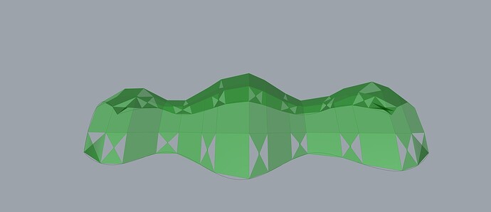

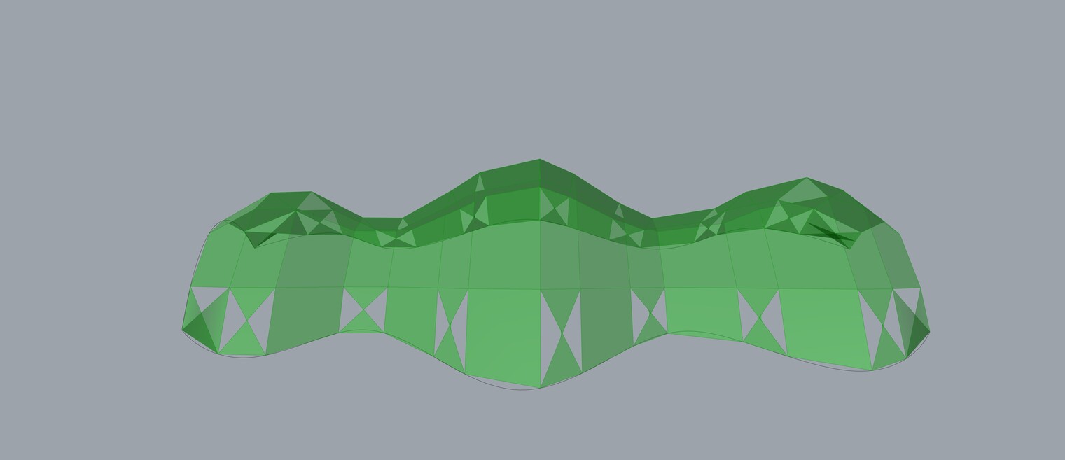

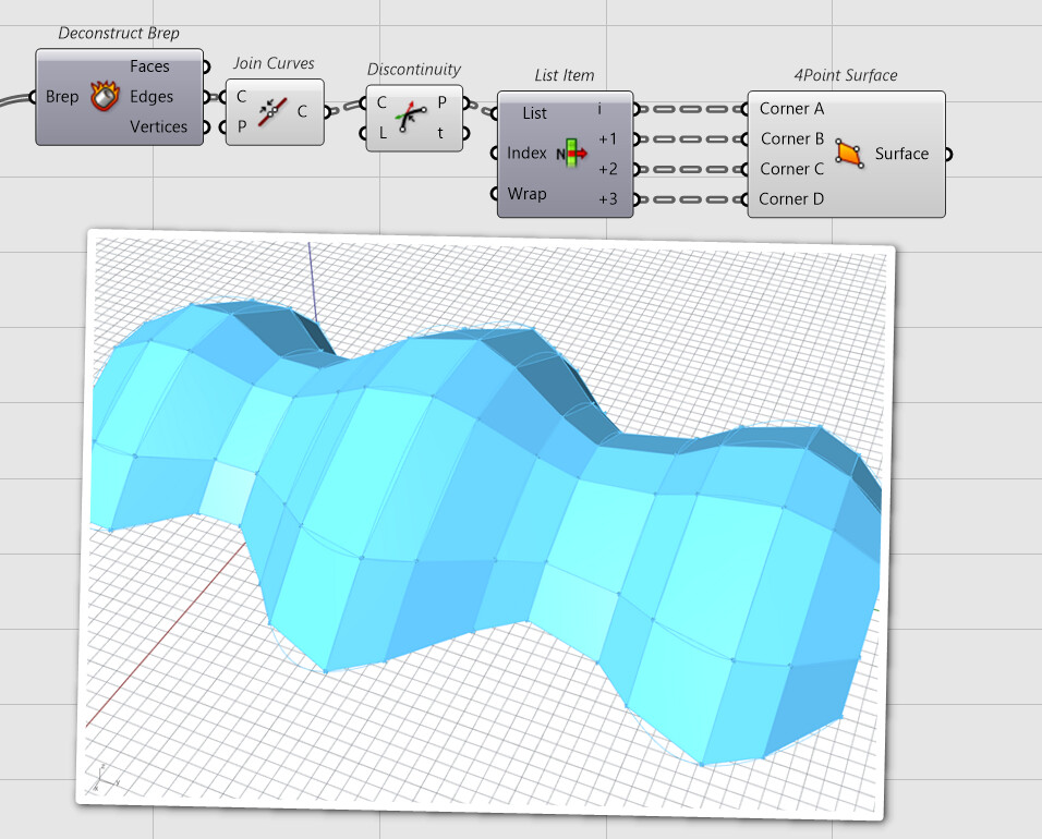

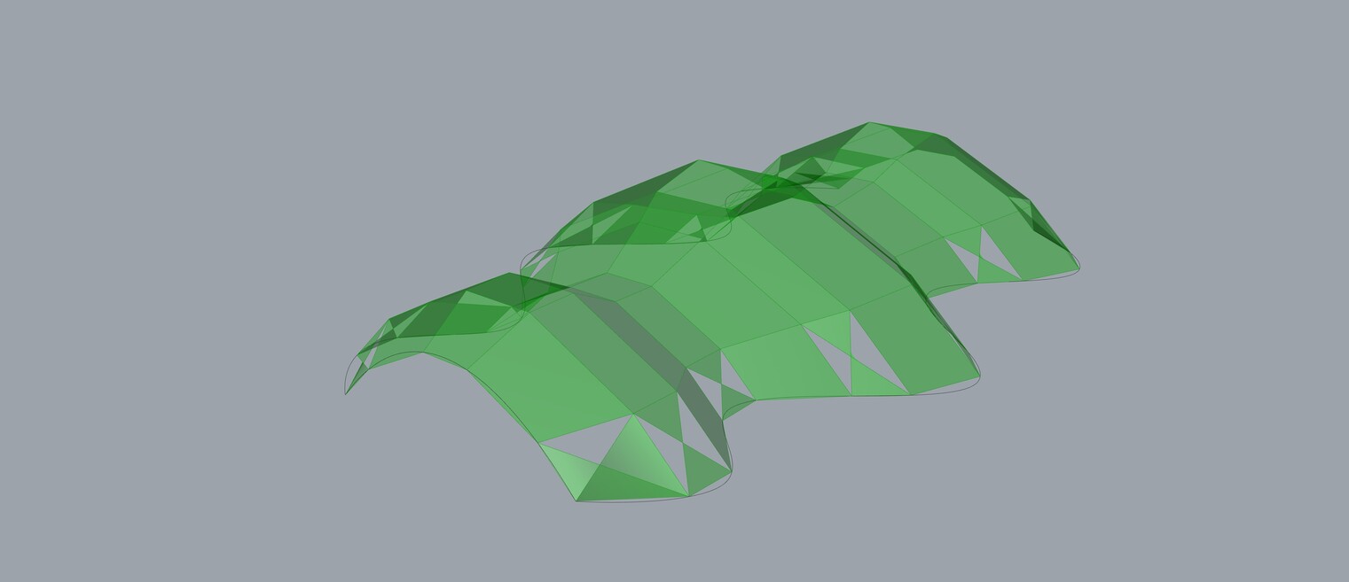

I am trying to do a freeform surface paneling, but encountered a problem with some panels.
They are somewhat disoriented, and I think it is because there is something wrong with the data structure.
Is there any way to solve this problem with the method I am using?
Thanks and most grateful for any Tip or suggestion!
[Surface Paneling.gh](https://discourse.mcneel.com/uploads/short-url/pbITSFRPvAbeROKXanv4JA7xWM7.gh) (24.6 KB)

(I doubt that the problem is caused by “Surface Split”)
