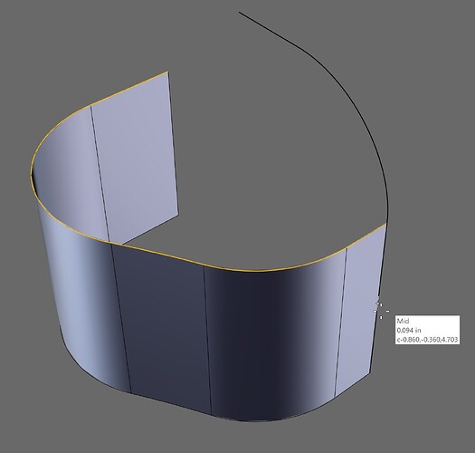

Doesn’t look to me like anything was done to fix Sweep1. It still makes the same surfaces with bad edge curves. In RhinoWip when you join the sweep result to the EdgeSrf surface made from the sweep’s edges it no longer makes a BadObject, but Instead the join just fails. Commandline says: Unable to join surfaces or polysurfaces. That is not much improvement.
IMO, the real fix would be to get sweep1 to work right. Otherwise it just another example of a Rhino tool where if the user wants it done right they have to do it themselves manually.

In Rhino8 SelBadObjects selects the result of the sweep and Check command gives this warning:
Rhino polysurface object is not valid.
brep.m_T[5] trim is not valid.
trim.m_type = singular but trim.m_vi = [7,14] (the m_vi values should be equal).
brep.m_L[1] loop is not valid.
brep.m_T[loop.m_ti[1]=5] is not valid.
brep.m_F[1] face is not valid.
brep.m_L[face.m_li[0]=1] is not valid.
ON_Brep.m_F[1] is invalid.

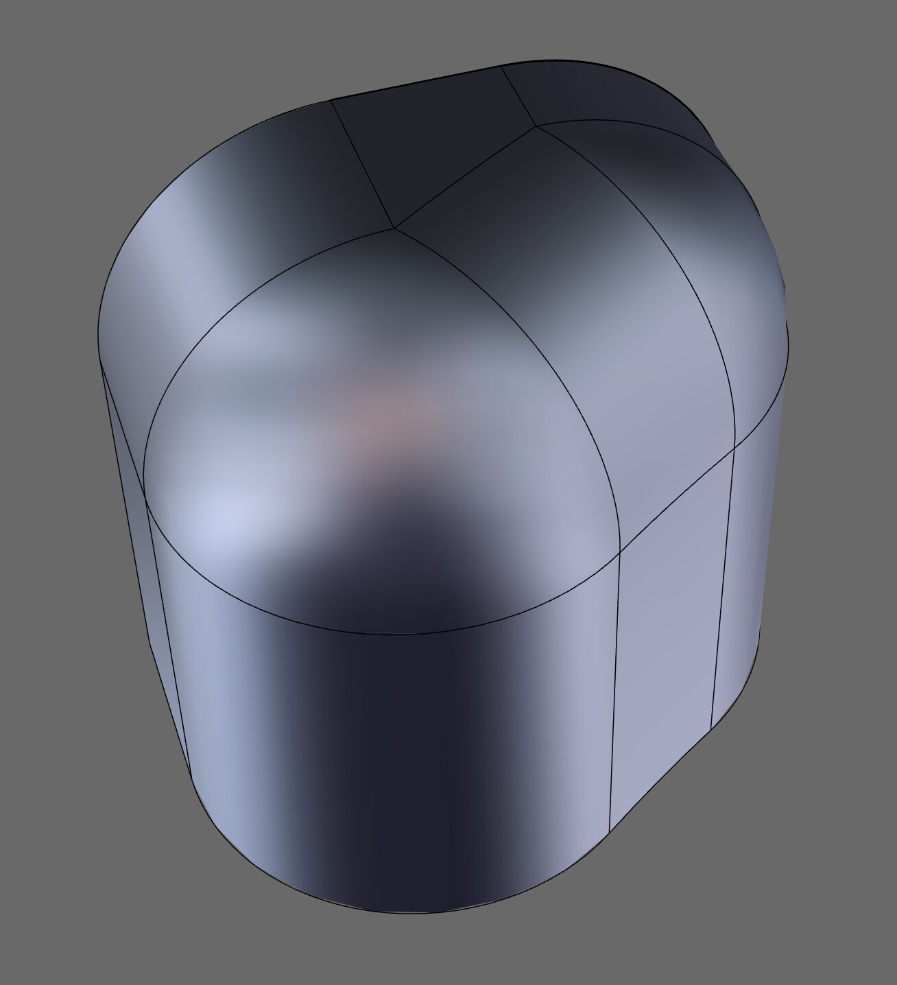

The bug is caused by the larger round surface which is split into two halves. When I extract them and build a replacement using the bottom surface edge as an input, and then build the top EdgeSurf, I can join everything properly. However, then the other arc extrusion on the top becomes a bad object. Untrimming the bad surfaces and joining them together fixes the bug.
I wonder why Rhino is unable to build a single surface, considering that the input is a proper arc edge of a whole vertical surface? Maybe exceeding the 90-degree limit of degree 2 surfaces before adding a knot forces the split?
Also, the resulting straight surfaces are degree 2 in either direction, even though the input curve consists line segments that are degree 1.
There is another bug related to the ! _Radius command. When I inspect some radius and then try to check a straight line or edge, Rhino reports the last value instead of 0.
The best way to handle this case is to NOT use the joined curves. Instead, run the ! _Sweep1 command and then activate the “ChainEdges” option from the Command line. That also generates clean surfaces (no longer splits the larger radius surface).
