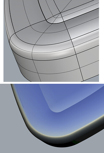

Before join the surface, the surfaces look smooth, but after join, the surfaces seem not connect smoothly. Any advice? Thank you.

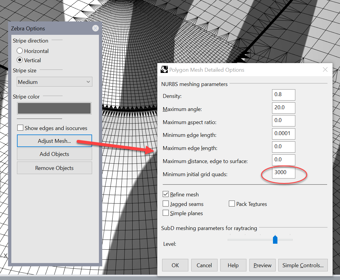

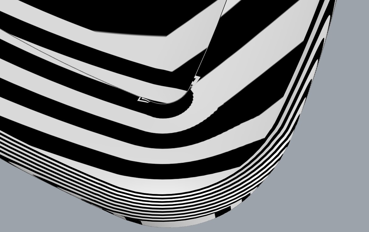

Hello - please try DivideAlongCreases >SplitAtTangents=Yes on all these surfaces. Then, adjust the analysis mesh something like this:
That should look better. The issue is, surfaces that are internally less that curvature continuous are sometimes difficult to mesh cleanly - splitting them into individual but joined faces is better for meshing and some other operations as well.

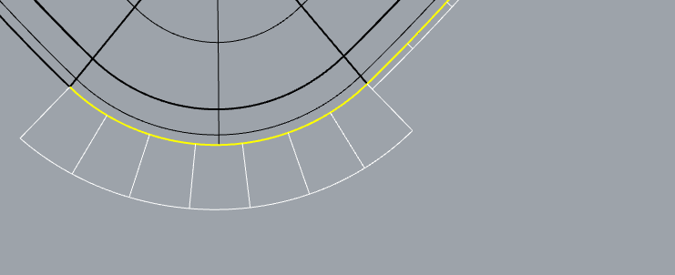

In addition some of your surfaces could be a lot cleaner:
I would replace this planat surface with a trimmed plane (PlanarSrf command) and avoid having the pinched in points at the tip:

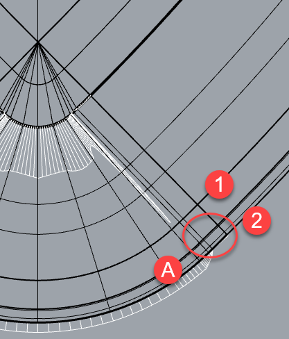

@hungwai.lim - I would still try to model a little more cleanly - for instance here, the messy surfaces have curvature at ‘A’ more like the neighboring surfaces 1 and 2
I would make it so that the surfaces follow the logic of the curvature in your design

The rendering of the joined surface is not good
Edit: DivideAlongCreases fixed the issue. Many thanks!

@pascal Wow how did you fixed the curvature at ‘A’? The tip profile is tangent at ‘A’, I use Sweep1 to create that tip surface.
Edit: Cannot figure out the steps, could you share the steps and commands? Thank you.
