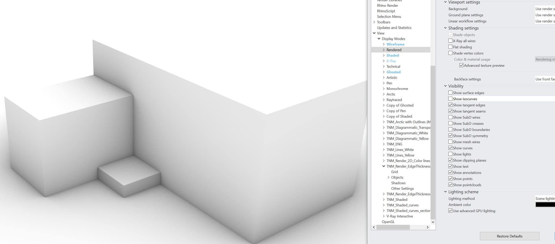

Surface edges not displaying
The display style I want (visible edges) V7
The style I got:
V9
V8
Reset to default won’t help.

Hi @Piotr,
Just a quick check,
Is this setting on?
This could be 1 reason that your not seeing surface edges
If possible, could you share your file. I could check if there are showing on my device.
Hi @Piotr,
Thank you for the file, I see that you have a layer called glass, which also has a Opacity property.
Can you test with making that one “solid” again? If I remember correctly I had some trouble with that in the past as well.
I am seeing surface edges, but it might be that my Rendered display mode is different then yours.
I might also miss some textures?
(file opened on Rhino 8 SR10)

Can you repeat it with a simple example as well or is it specific to that file? In any case a sample file will be helpful, maybe Jeff has one of those cards.
Interesting…
New file has the edges displayed correctly:
Object to the left is a Ghosted mode, the one to the right is a render mode with simple glass applied.
Something must be going on inside the file.
@Piotr there is definitely something odd going on with edges when there are transparent objects in the scene.
I’ve added RH-83229 Edges are not displayed correctly with transparent objects
@Piotr this issue seems to have been introduced in 8.9, if you want I can send you 8.8 which does not have this issue (but note that in that build there is an issue with clipping planes and GPU tesselation)
