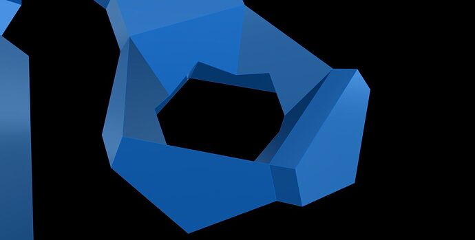

I found a weird glitch where if I take this brep:
… and then convert to SubD in grasshopper, I get a broken vertex in one spot, like this:
For some reason, if I rotate the referenced brep in Rhino a little bit, it fixes it:
Any idea why this would happen?
Here’s the definition used to convert it, with internalized data. There’s a curve object you can highlight to create a bounding box around the problem area so you can find it, and a stream filter to toggle between the input brep and the slightly rotated input brep.
Sub Glitch.gh (539.0 KB)
It’s a naked edge.
Moving the object 0.001 units in Y direction eliminates the issue too.
I think it has to do with the tolerance.
Putting an Align Vertices component before your NGON script solves the problem.
Pretty cool object…

I’m confused, the input object is a closed polysurface.

The problem is where you create the mesh from Brep. That new mesh has naked edges.
I had to create meshes from polylines recently too and chose to use a script. In your case creating the meshes from Brep Face boundaries directly leads to the meshes you want to turn into Ngons.

Ah, gotcha. When I input a mesh made by running _Mesh and _AddNgonsToMesh in rhino, it works fine.
I didn’t make the python script, I thought it was just a one-line script that used whatever the python version of Rhino’s _AddNgonsToMesh command is.
I’ll play with tolerances. I’ve had other problems with this script failing with certain tolerance conflicts and with nonmanifold edges.
I just found this post here where Giulio Piacentino posted a better script to turn Polylines to NGONs
