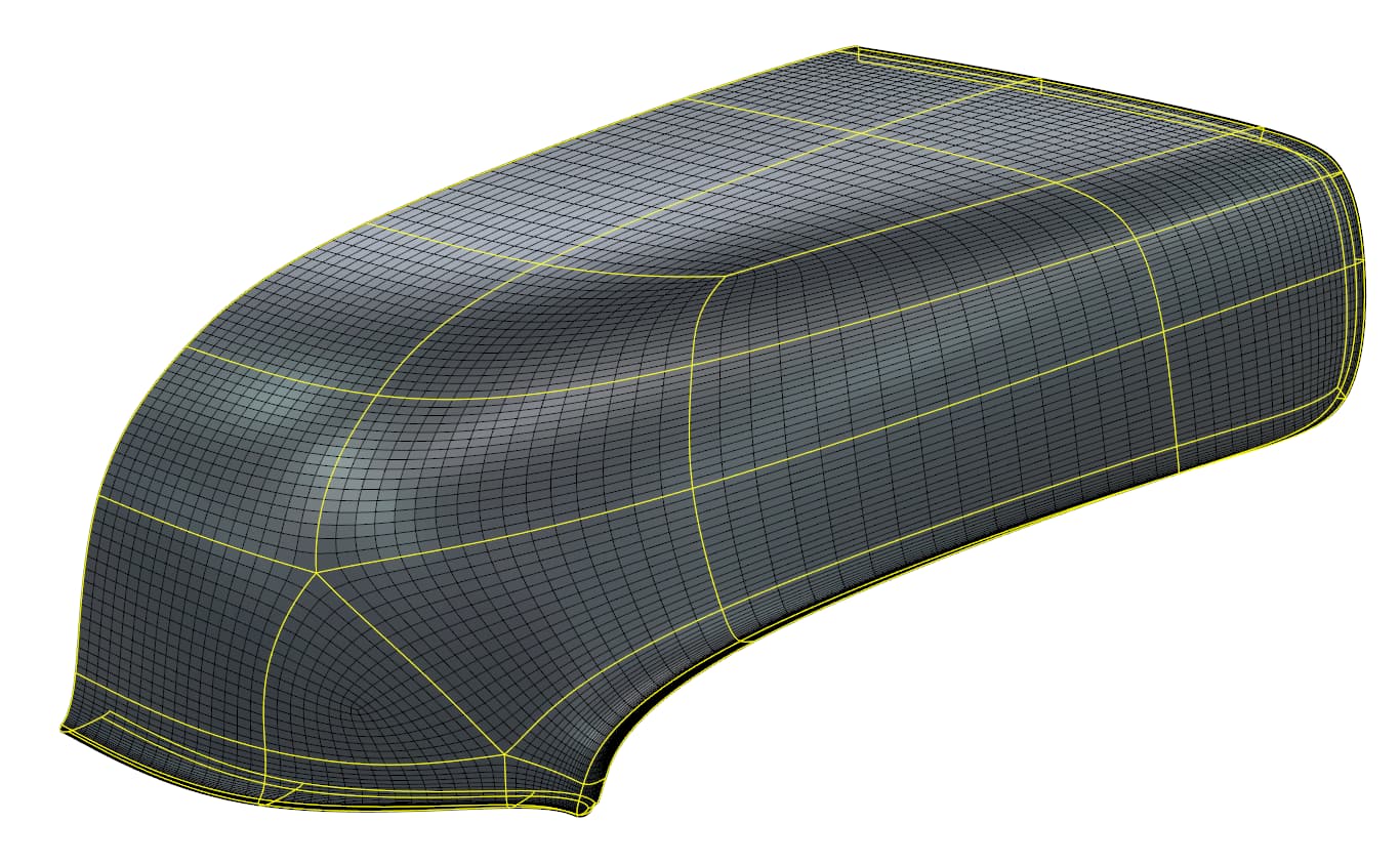

Did some more tweaks an added a few glossy details. All subd of course as these builds are purist stuff for the fun of it. Oh, and threw a PBR material on it too to get the car paint shine, hope you like the color, deep red is always great together with, crome, glass and it’s shadowy areas IMO. All lit with a single HDRI as it’s a much better modelling light than panels, so I think I’ll use that for the final renders too, if I ever get to that stage.

good lord…this is looking amazing!!!
one nit pick with most subd cars… the panel gaps are always a little sloppy… (you have done way better than most)
You may consider merging all the panels (hood, doors, etc) into continuous surfaces and then converting to nurbs at the end, and then add in your panel gaps with a nurbs trim.
or try creasing the edges, then convert to nurbs and fillet.
or crease the edges, add tiny bevels and then delete the creases to keep it all subd .
Or ignore me completely and carry on with this awesome model.

Yeah, I agree and I keep them single faceted while I get the shape right and then I add an extra face to the edge when done. Too high complexity while tuning is just too much work.
Does this look better to you? Hood transaction only. (…still lot of fine tuning to do :wink: )
