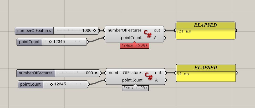

Your main problem is here:
If you write two version of serial loop and inside first you create Class instance ( … new double[3]) while inside second loop there is no such code, second loop will be much faster (easy to test).
So your problem has nothing to do with Parallel.For but with your code.
There are probably other things that can speed up your parallel.for execution as well, but first you have to create your solution without that new new double[3] …
here is simple code test
Loop_Performance_Issue_01.gh (8.1 KB)

Yes but if I try to overwrite the same array with multiple threads accesing it at the same time I would have a bad time, at first I thought the compiler would create copies for each thread like it should for any variable but it doesn’t, maybe I could optimize it a bit by simply creating the pointList array as in the serial example but (one dimension) inside the parallel for, I think it would work and maybe it is in fact less expensive as memory would stay a little bit more contigous?
I’ll give it a try. Your example is obviously what you’d expect but with real data I am getting strange lower performance. Thanks.

If you have control over ring.GetPoint() method you cold write an (optimized) overload which returns Point3d for given index (int i). That could improve performance of Parallel.For loop significantly…
No I don’t have control over that it’s a library function.
I didn’t remember but yeah the jagged array was to stay away from this:
I came to a conclusion, trying to beat single-threaded non CLI C++ (the library I am using) by using multi-threaded C# is like bringing a knife to a gun fight I desist.
