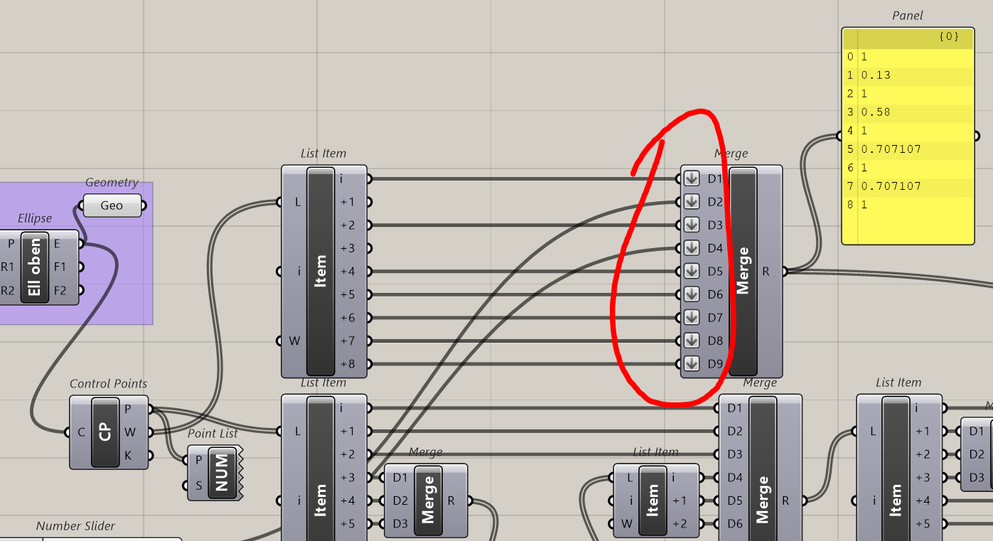

I reconstructed an ellipse to a special shape by moving its control points and creating a new “Nurbs curve PWK”.
The second step is to alter two control point weights with sliders which i plugged into position 1 and 4 of a merge component. When checking the output of the merge, the values appear on position 0 and 1 of the list.
Additionally both of the altered values influence the same CV (1).
Is this a bug in the merge component or am I using it wrongly?
curvePWK_merge.gh (37.9 KB)

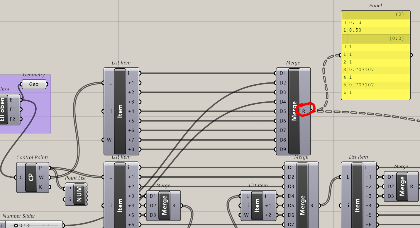

if you remove the Flatten and check the Data Tree output by the Merge component:
Flattening just removes the Branches, and that order is maintained:
easiest solution is to flatten this:
safest solution is to flatten all inputs of the Merge:
