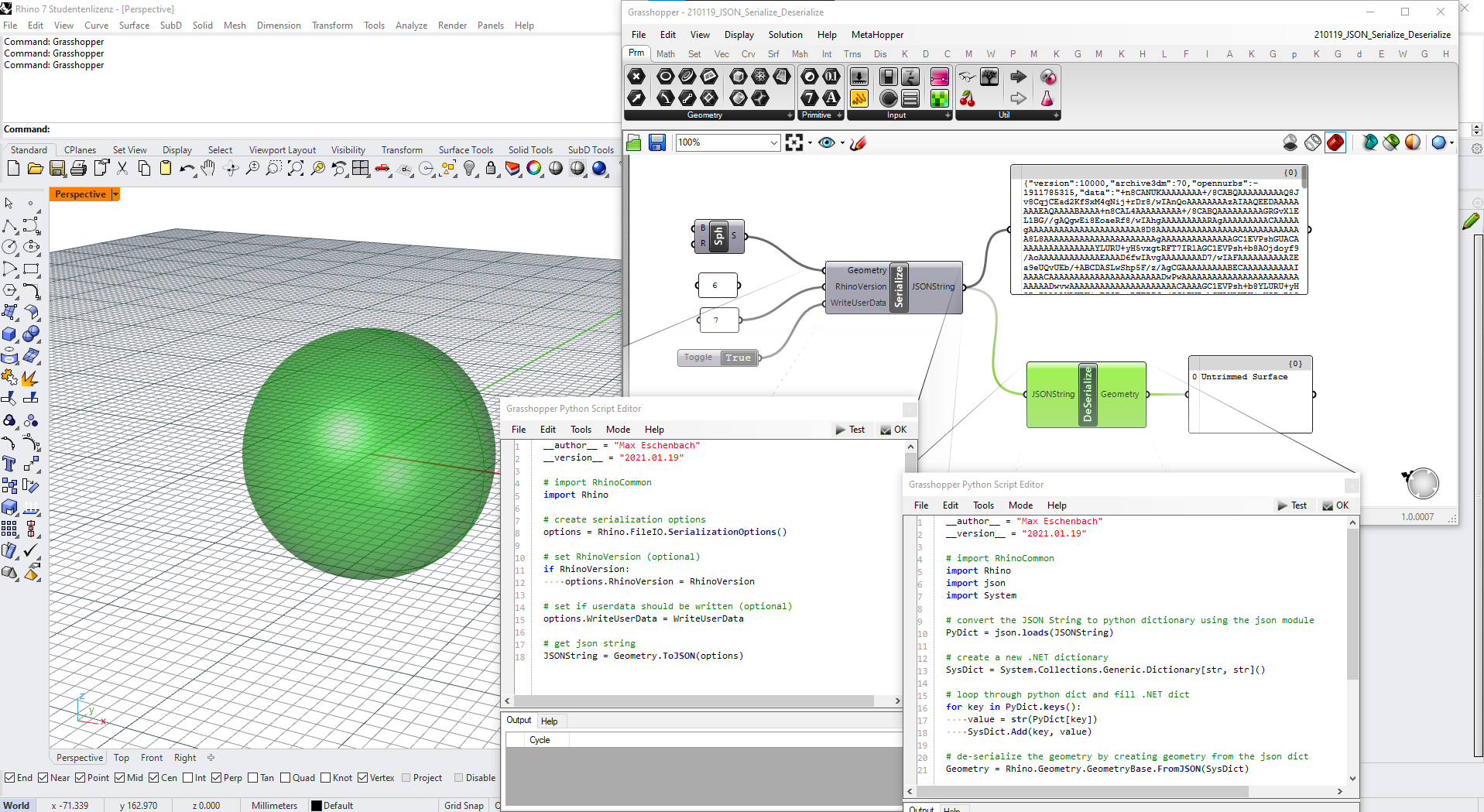

Since I love it when people resurrect this old thread (no irony!) and the JSON thingy got me really interested aswell, I threw together a really minimal example in the hope that it might help @osuire and others:
Code for Serialization:
# import RhinoCommon
import Rhino
# create serialization options
options = Rhino.FileIO.SerializationOptions()
# set RhinoVersion (optional)
if RhinoVersion:
    options.RhinoVersion = RhinoVersion
# set if userdata should be written (optional)
options.WriteUserData = WriteUserData
# get json string
JSONString = Geometry.ToJSON(options)
Code for Deserialization:
import Rhino
import json
import System
# convert the JSON String to python dictionary using the json module
PyDict = json.loads(JSONString)
# create a new .NET dictionary
SysDict = System.Collections.Generic.Dictionary[str, str]()
# loop through python dict and fill .NET dict
for key in PyDict.keys():
    value = str(PyDict[key])
    SysDict.Add(key, value)
# de-serialize the geometry by creating geometry from the json dict
Geometry = Rhino.Geometry.GeometryBase.FromJSON(SysDict)
Here is also the corresponding gh file shown in the screenshot: 210119_JSON_Serialize_Deserialize.gh (9.2 KB)
