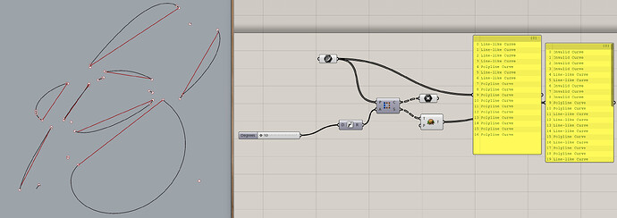

SplitAtCorners seems to have gone REALLY nuts this time.
[240802\_PROG\_SplitAtCorners gone nuts.gh](https://discourse.mcneel.com/uploads/short-url/lpD0QCD3sgw9CpE5z30aPJH31RE.gh) (8.6 KB)
 ![240802_PROG_SplitAtCorners gone nuts](https://global.discourse-cdn.com/mcneel/uploads/default/original/4X/3/6/a/36a75ca5c16d53452885dabfd707698807b78c53.jpeg)
It generates a bunch of invalid Curves, and closes the polylines for no reason.
Is there a robust alternative somewhere ? I rely on this for many things.

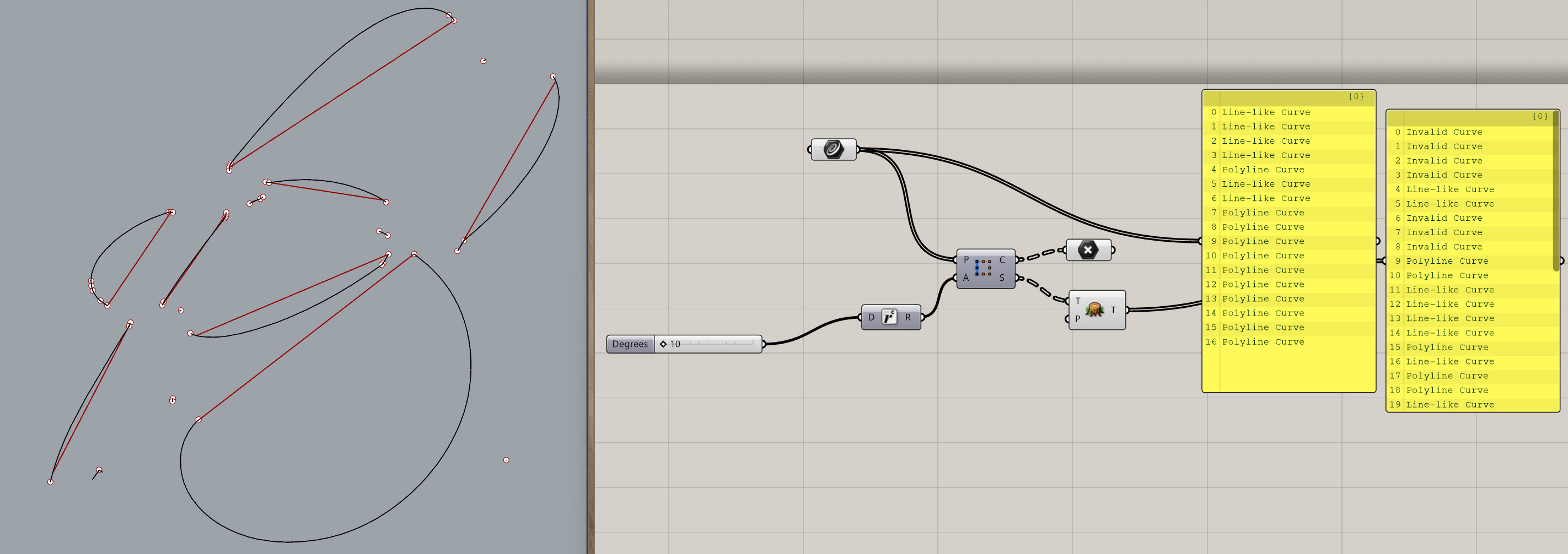

Did it ever work on open polylines?
I don’t think I’ve touched the code in that component in over 12 years, so I guess the bug has been there all this time.
Anyway, I think this works now:
[splitatcorners\_fix.gh](https://discourse.mcneel.com/uploads/short-url/4DI7FAmmkAovpxnpgwQ0zOjePrc.gh) (19.3 KB)
(it was just missing a “+1” for the case when the curve is open)

Clearly the component is not working, but the script I shared just above is the fix.
I’ll push the component with this into the next release.
