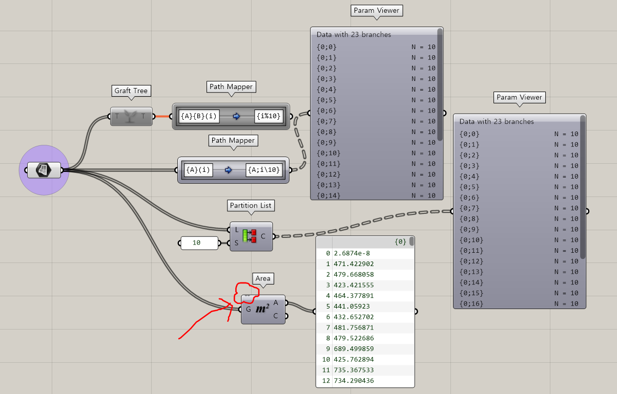

Hi, I have several pieces I’m trying to get the area for numerate for laser cutting but my system sucks and crash so I want divide into several groups maybe 10 and get the area calculation avoiding my computer crash for a lot of calculation.
I regulary dont use path mapper it is the good way to get the division?

Hi.
Several components of GH in R6 WIP support multithreading including “Area”.
If you have some difficulties of using path mapper, then why not use “Partition List”?
Also, it would not be easy to reduce your calculation time simply by grouping.
It might help calculate area one by one by using a loop algorithm…
thank you so much I was confusing split list with partition list :confused:

/ is regular division, \ is integer division. Integer division does not include any remainder.
@DavidRutten that option (marked in red in the picture) is available in Rhino 5?

No, it was added quite recently. Rhino6 only.

Oh the Area component has been around for ages, since the beginning I imagine. But the double-dot options marked in red are a new feature.
