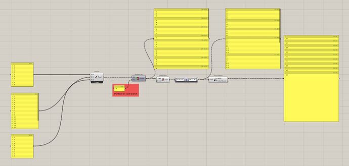

Hi Christian,
If I understand you correctly, you want to split the branches with different partitions, correct? Something like this could work, just graft the size input in the partition list component, as you are already doing and use the Shift Paths component at the end to keep the same structure. As I do not have you data, you may need to play with the input of the Offset in the Shift :sweat_smile:.
Thanks Fernando,
so I can get to the goal. Thanks for your time
