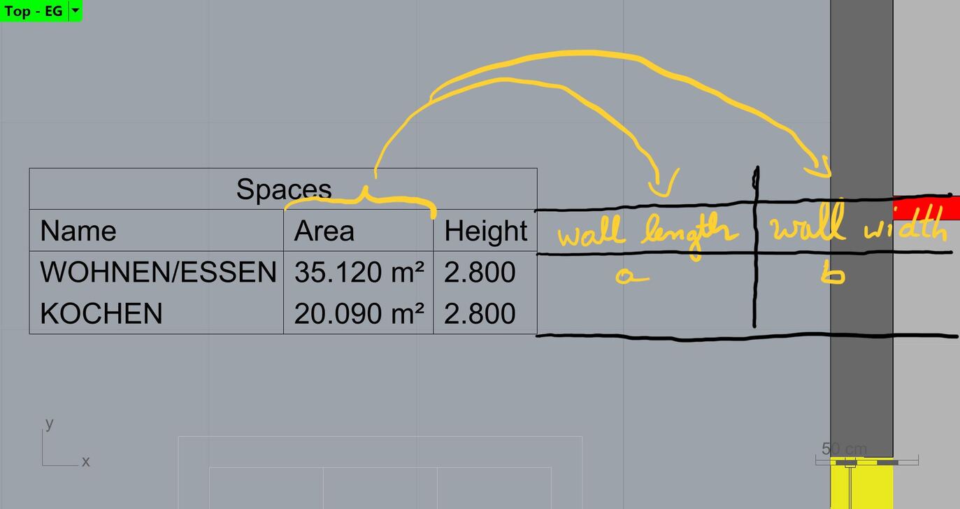

i have a little question with reference to space table. Is it possible to show the length and the width off the area in the visual arq space table? :thinking:
Hi, it is not possible to show the information of the wall segments that are enclosing a Space. However you can calculate the wall length around a space by its perimeter. Go to the Table Styles (vaTableStyles), add a new property field, and select the “Perimeter” parameter, from the Source tab:

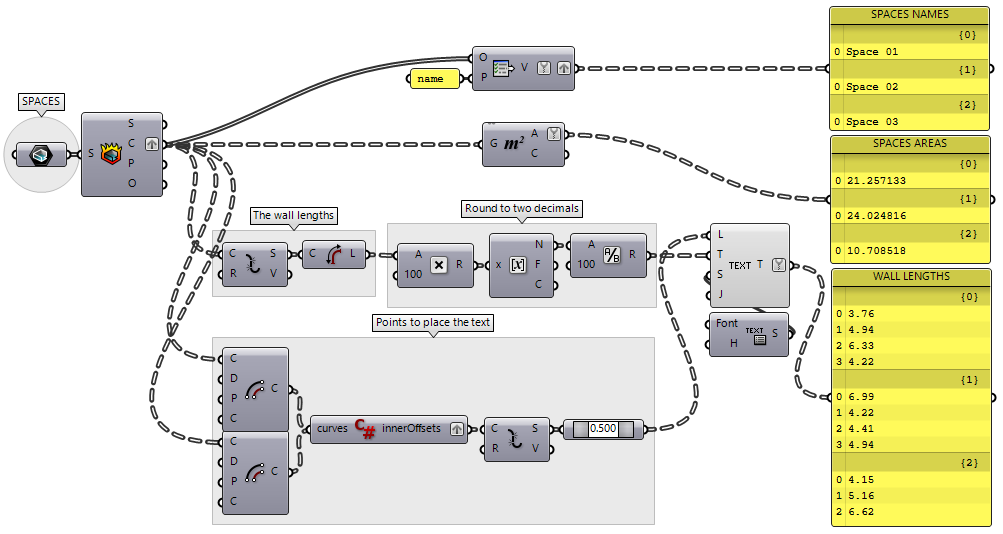

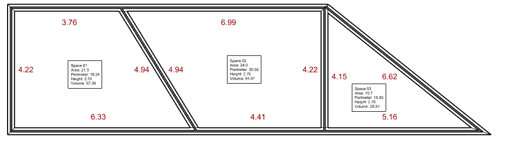

Currently you could achieve something similar with Grasshopper:
spacesWallLenghts.gh (15.8 KB)
Wow, special thanks to you Ramon! Its a very good alternative.
This helps because some builders and institution want to see how you get to the size of the area.
