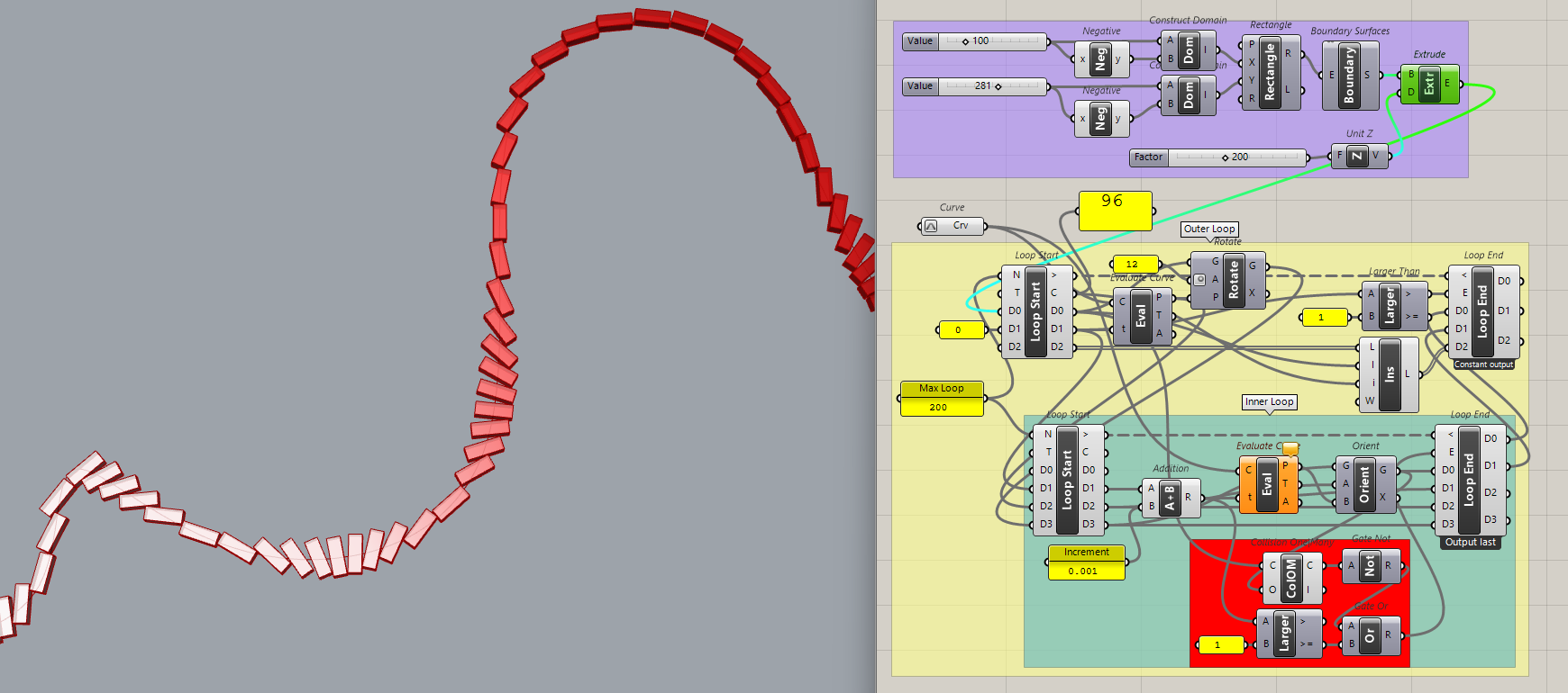

Seems to me that I’ve done this sort of thing many times on this forum but can’t seem to find them now… Found this from 8.5 years ago using nested Anemone loops. Cool but different:
[RecursiveBrick_2016_Jan2b]
RecursiveBrick_2016_Jan2b.gh (25.2 KB)
And this one, which is something very different but also uses Anemone:

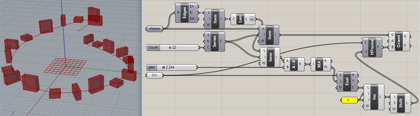

I found this one (using a list of shapes) on my PC but can’t it on the forum:
array_along_crv_2017Jul13b.gh (20.2 KB)
