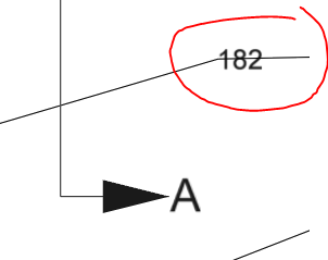

It would be great if text could have a background fill color option.
Like here when we need to add height data to terrain curves:

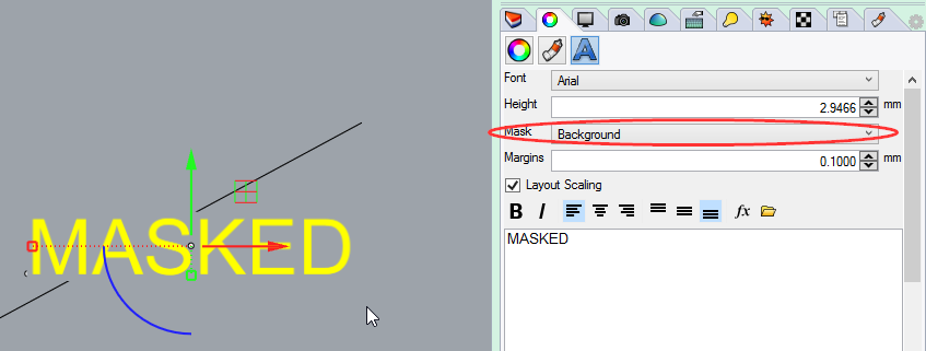

Do you know anbout the mask option for texts?
-Willem
No… that does the trick!
I looked for “background” when I made them in V6, and since it was noting there I didn’t look in the options after it was created:

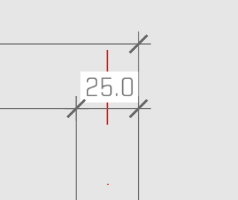

also works on dimensions :wink:
