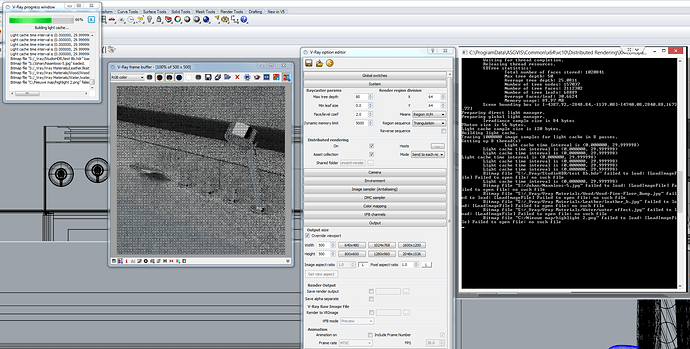

My situation: At work we have a workstation which runs Rhino 5.0 with VRay 1.5
We render a lot with this pc and it took a long time so we decided to buy several render pc’s (we first tested with another pc in the network (both 64bit Win7’s) and it worked fine.
Having a bit of trouble with our system managers, we bought 2 Win8 systems and connected them (including the workstation) on a separate network.

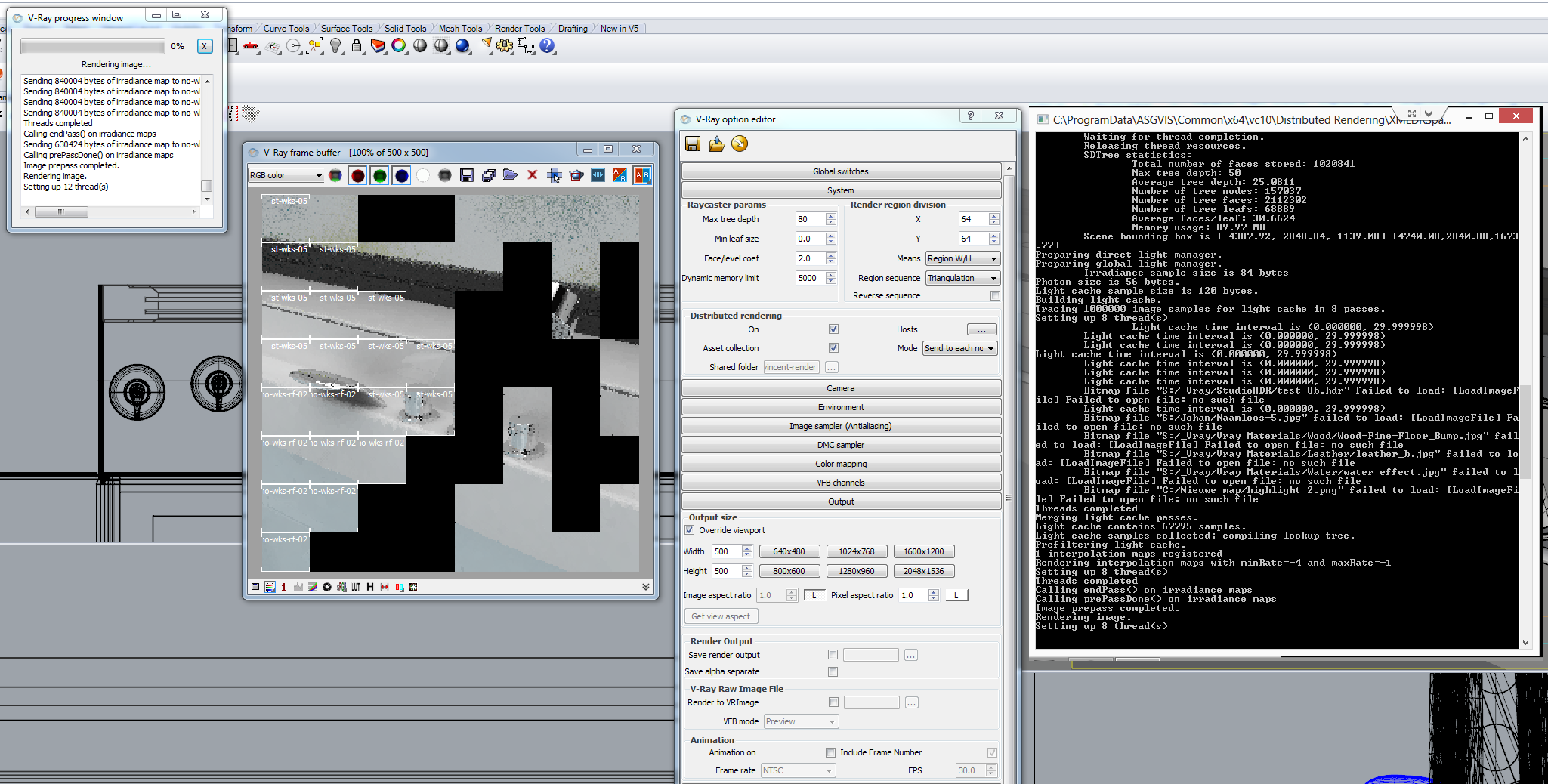

However, when rendering the second phase, we get black blocks. (only the blocks rendered by the 2 other systems though)
I’ve added as much images as possible to make it extra clear for everyone willing to take a look.
On the right is the XMLDRSpawner of one of the network pc’s (vieuwed through teamviewer)

But it’s probably that the slaves do not clear their memory fast enough to be ready for the next bucket on time. There’s a few discussion on this on V-Ray’s forum and a few solutions you might try.
Some threads on the subject:
http://forums.chaosgroup.com/showthread.php?73951-Still-the-same-DR-bucket-problem
http://forums.chaosgroup.com/showthread.php?72197-Non-Rendered-buckets
To close this topic, this problem was solved.
Although even at the VRay forum they weren’t sure what caused the problem,
sharing a folder on the render pc and making it available to the network render pc’s made sure the renders were carried out normally.
