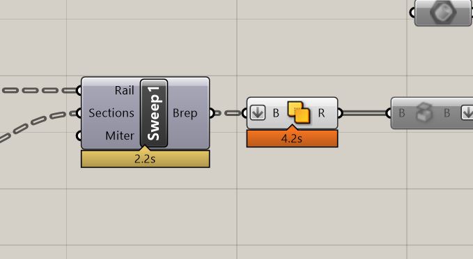

I’m trying to substract object B from object A.
Object A is a solid CUBE, object B are multiple sweeps.
I’m using “SolidDifference” but I’m not getting correct results and I’ve tried everything I thought off.
Here’s a screenshot of my problem.
I’ve highlighted the (circle) sweeps which were supposed to be cut out of the top surface of the box - but the whole upper surface remains closed, without the cut. Even though bottom half of the pipe is visible if you scroll inside the volume of the box.
I’m completely lost and I really need help solving this issue.
3_5.3dm (12.5 MB)
3_5.gh (14.2 KB)

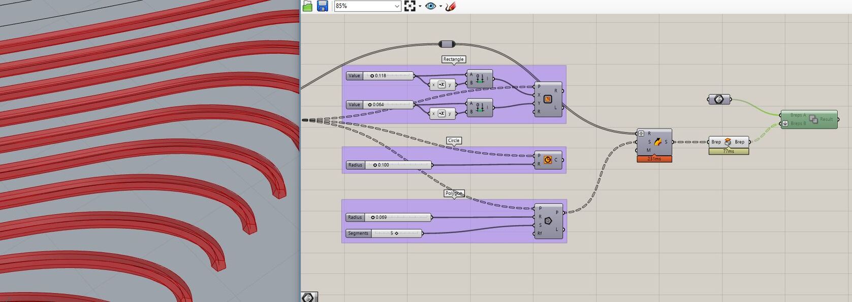

Is this what you want?
3_5_re.gh (180.7 KB)
why you use circle and sweep ? simply use pipe
Thank you @HS_Kim and @anon39580149 .
The reason I’m using the regular sweep instead of pipe is that eventually I’m going to change the section for something else. Circle is for testing purposes only.
Do you guys know why sweep is not producing the same result as pipe does?

you need use other method to create sweep
try this with different shapes
3_5_new.gh (13.0 KB)

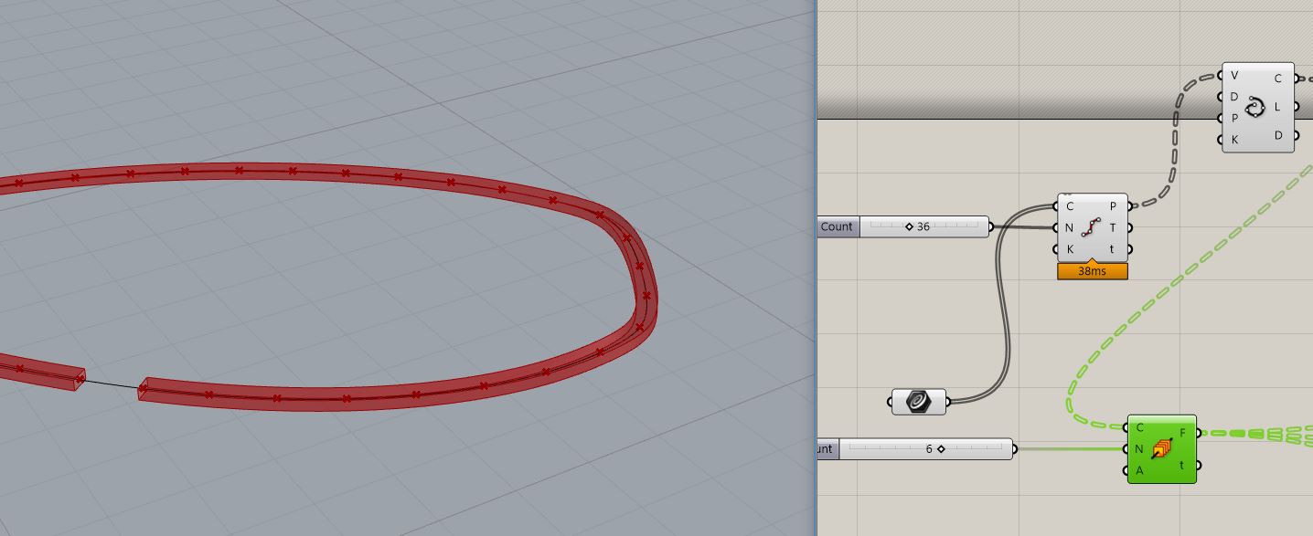

It seems to me that once I remove the closed splines it works. I haven’t tried if it works the other way around (having only closed curves).
Is there a function that might uniform the curves in the sense of being opened or closed?
Because my pattern is pretty much fixed and can’t change it a lot - it needs to have opened and closed curves.
best,
m
I’ve seen this issue before, actually on a very similar post (Acoustic panel ellipses - correlation between sections A-B1, A-B2, A-B3 etc. and the depth D1, D2, D3 etc), but I’m still not sure where the problem arises. In the past I used Rebuild Curve, with a high number of control points to approximate the original, and this seemed to work…but not this time. I tried all sort: rebuilding using interpolation curves, making all of the curves periodic through python…etc, etc, but nothing seemed to work 100%.
In the end I split the closed curves into two, and this seems to have worked.
3_5_V2.gh (185.1 KB)
I would like to know where this issue comes from though. Not sure if its a bug.

Sweep is funky, not very yielding - if you stick to lofted circles using length division then I believe you are where you want:
The group in yellow towards the bottom right is a sweep of a circular profile (if you still want to use a sweep), yet it’s using the BullAnt plug-in, which you’ll have to download first.
Check:
3_5.gh (45.7 KB)
Also [edit], for other profiles (not circles) I suppose you can place/orient them on the same perpendicular planes before lofting

I use method of Adam Mounsey to separate closed and opened curves than i use sweep for opened curve and loft for closed curves, the result is better and union work fine
3_5_new.gh (35.5 KB)
