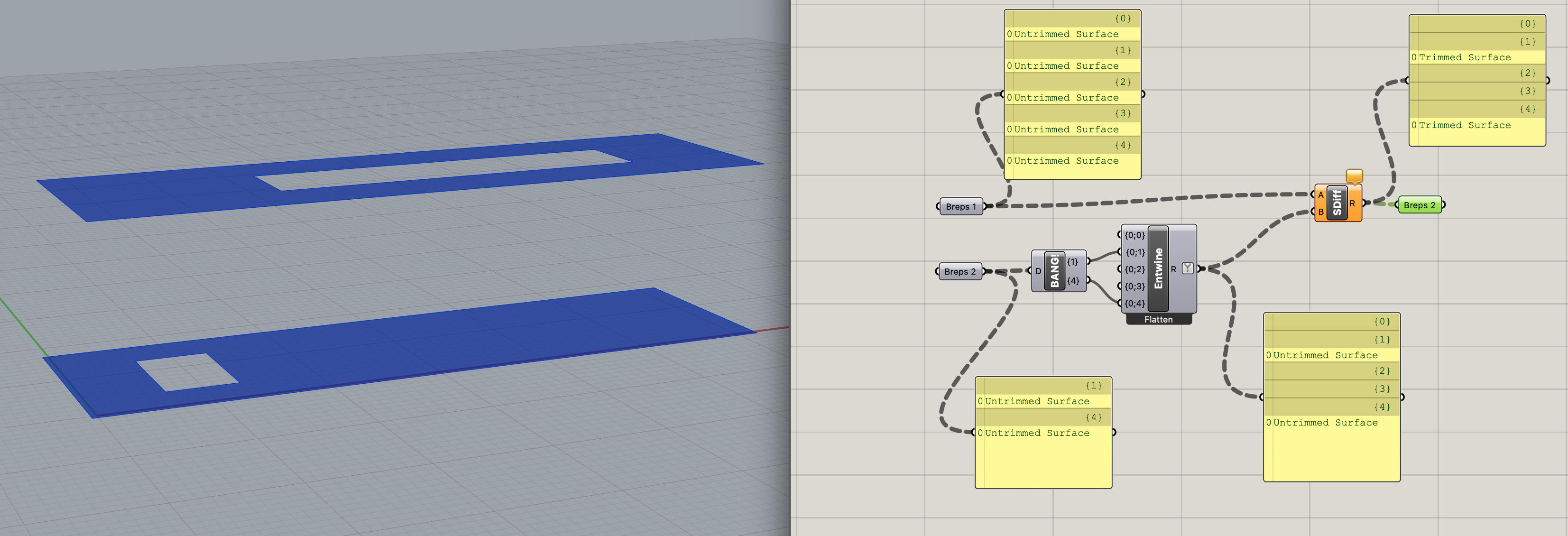

I’m currently working on cutting polygons with various surfaces. I’m using a specific data tree structure that I need to maintain due to the complexity of the overall problem. When I apply the cutting component, everything works well except for one particular opening. I’m having trouble understanding why this is happening because all the openings are created using the same point structure. I’m searching for a reliable method to perform these operations consistently.
I’ve attempted to recreate the cut using both the Python and C# components, but unfortunately, it’s not working as expected.
Any assistance on this matter would be greatly appreciated!

It appears to work correctly for me in R7 so might be a tolerance issue? ‘View | Display Options… | Units | Absolute tolerance’ = 0.001.
P.S. I take that back, one of the “opening” surfaces fails, as @kev.r has explained below.
However, these are flat surfaces, not “solids” with thickness, so RDiff (Region Difference) is more appropriate. It works too except you have four branches in Slabs. Outline Surface and only three branches in Slabs. Outline Surface.
Besides the issues @Joseph_Oster pointed out, one of your surfaces if flipped in orientation compared to all the others.
This is the surface that is not being cut out. If you flip it (or construct it in the same way as all the others) you will get the result you’re expecting.
-Kevin
Thank you for your answers, that is right…flipping the surface solved the problem :slight_smile:
