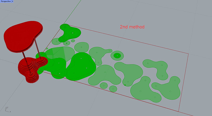

Hello everyone,
I am trying to do a solid difference between the shapes and pipes, but i am having some troubles as you can see in the images. Don’t really know why it is happening since the whole geometry seems fine.
Also I am having trouble to put the pieces holes into their correspondent shape on opennest. I tried 3 different methods and they are all going wrong. Maybe is because of the geometry issues I am having when do the solid difference.
metopensthelp.gh (108.7 KB)
for the top part I think it’s ok to retrieve the Bottom facing surfaces, but for the bottom part I think you need the Top ones (the only difference is on the biggest and most outward element of both, for which the pipes do not create a pass-through hole)
the nesting looks good, there are just those little circles due to the pipes not fully compenetrating the most outward block in both direction, so the bottom/top surfaces of those blind holes are also retrieved by the SrfDir clusters
metopensthelp_Re.gh (123.2 KB)

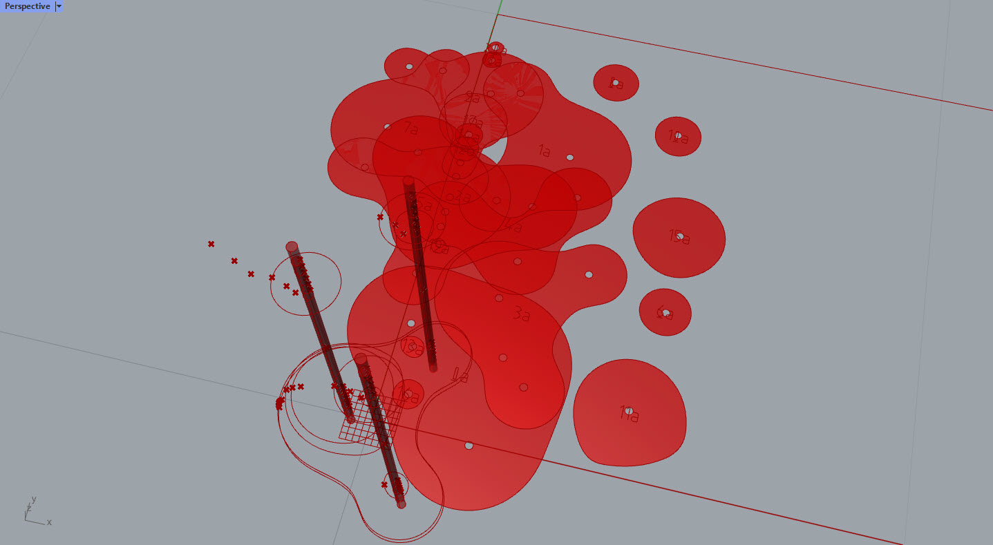

nice man thanks! going further on after your file, I was trying to enumerate the pieces, but it got messy, I tried sorting the list in Z direction before connecting it to open nest plugin and this in the photo happened.
All I wanted now is to be able to number the curves according to its Z position, so if I have more than one piece it will name for example ‘2a’ and ‘2b’.
metopensthelp_ReOther.gh (107.1 KB)
You think is possible to do this in grasshopper or I will have to start to code to do it?
here it is:
metopensthelp_Re_Re.gh (135.5 KB)
jeeeess man, you freaking rock! thanks a lot! I really thought it would only be possible with scripting!
