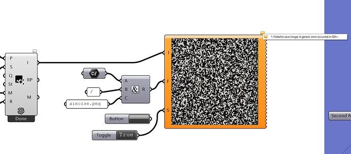

Image generation is very useful!
Not without errors(was trying to override existing image, worked multiple times but then stopped working:
For image generation seed would be great, but i am not sure openai gives you control over that.
Right now if you want to generate same prompt twice, you need to generate something else first, that is not very convenient.
NoiseSmartHopper_00.gh (2.4 MB)
Overall great component, waiting for future updates!

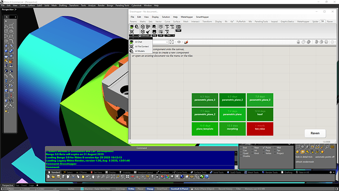

hmm, well I decided to dabble in it again, and actually got it to launch this time. :beers:

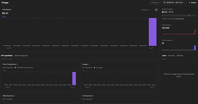

so far can’t get it to work.
looks like imma give up again until something gets fixed. got nowhere and wasted $00.41 so far plus tax lol.
There’s got to be an easier way to do this lmao.
Hi @lander thanks for reporting.
I guess the issue is with the new gpt-5 model. It was released 10 days ago and it might have introduced some breaking changes from previous api. 4o-mini and older models were verified and working fine.
I opened this issue on github to track the fix. I hope to patch it soon Gpt-5 api errors · Issue #304 · architects-toolkit/SmartHopper · GitHub
Thanks for testing!
Hi @lander , I checked and confirmed a small incompatibility between gpt-5 and the script_new tool (the one that adds new script components to the canvas). It is now addressed in 0.5.3-alpha (just released).
On models: gpt-5 is very capable but can be resource‑intensive. In my tests, occasional empty responses were likely due to external API rate limiting. As a lighter alternative, gpt-5-mini has been more consistent for me—you might find it performs better in this workflow.
Regarding auto‑connecting components you suggest in the screenshot: that’s a great idea. There isn’t a dedicated tool for this yet, so I’ve added it to the roadmap.
You can already try script_new by asking the chat to create a new script component for a specific purpose. It’s still under development: the overall logic is often good, but inputs/outputs may still need manual tweaks (types, names) and sometimes small code adjustments. Your examples are helpful and will guide improvements.
Thanks again for the feedback. I’ll share an update as the fixes and enhancements land.
