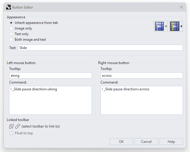

Another thing that drives me upp the wall with Subd slide is that you might have to change Across/Along per vertex, which I just can’t fathom at all:

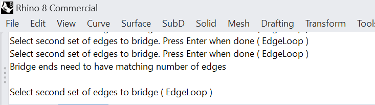

Today, I wanted to do a very small/quick thing: I couldn’t because we still cannot even use bridge with a mismatched number of edges on each side:

Blender just adds a triangle where it works best?
Hey, since the T-splines patent has expired, guess what Rhino could do that would be better. :wink:
Yes. That’s standard practice in all subD/polygon modelers.

agreed that’s frustrating, but you can add that option to the button (say right click for across, left button for along) if you want, or hot key a version with along/ across as per your needs.
But you do realize that Rhino doesn’t telegraph this at all, so what you are proposing is still a click, a wasted mouse move, and a second really unnecessary click and another mouse move for potentially every other Subd vertex you are editing? That adds up.
It does not telegraph it because the tool does not have this feature by default, but you can easily customize any tool in rhino by adding command line options
for instance in this case-
if you add
-slide pause direction=across
to the left click button you get slide across
if you add
-slide pause direction=along
to the left click button you get along.
the option is sticky between operations so if you pick along once, you’ll get5 along the next time you choose slide. if you pick across, you’ll get across the next time.
see below-
hope that eases the pain a bit… :wink:
