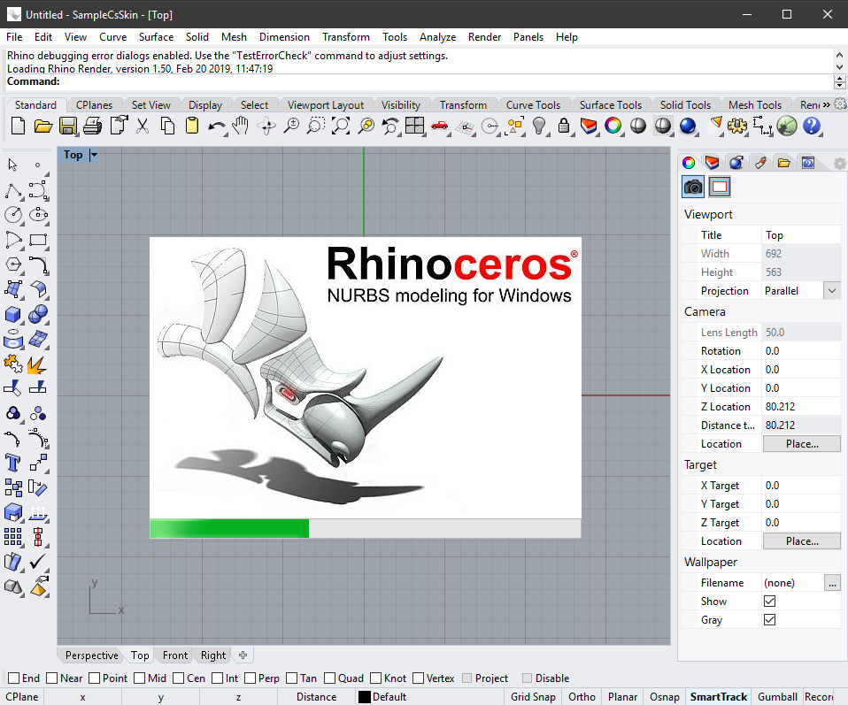

  • Screenshot of the resulting window showing custom ApplicationName and MainIcon. Should the icon be embedded (encoded)? Can we use a filepath? What size should it be? What extension?
  • NoSplash overridden

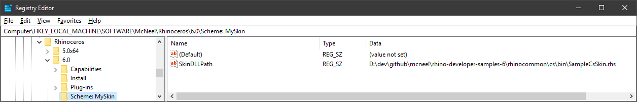

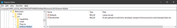

  • a screenshot of the registry is the name of the key Scheme:myskin or is it a sub-key? It’s unclear.

This is a screen show of the sample I mentioned above.

This means I don’t want to see the splash. How to disable it?
Hi @ivelin.peychev,
I don’t know anything about building assemblies with IronPython - sorry.
If you don’t want a splash screen, just override Rhino.Runtime.Skin.ShowSplash and do nothing.

Example above is great, notice however the space: :<space>myskind:
Correct usage is Scheme: MySkin.
