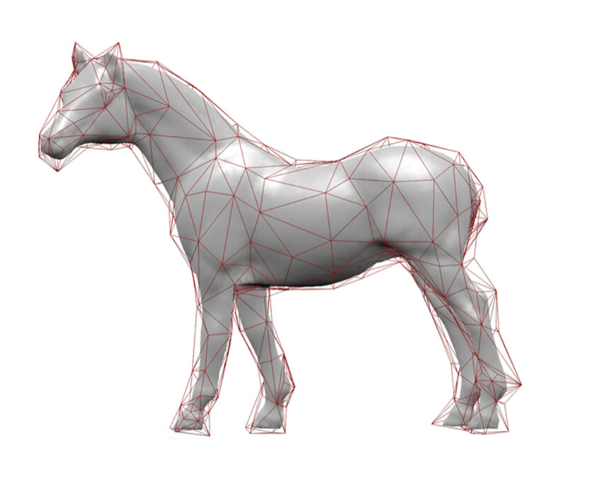

Hi @DanielPiker thank you for a fab component.
I have a question about the design of the cage. Is it okay in the demo that the dino mesh and the cage intersect?
I ask because the following quote is from, An automated method for generating customizable cages using barycentric coordinates by Ákos Tóth, Roland Kunkli (2018) https://publikacio.uni-eszterhazy.hu/2471/1/AMI_49_from167to180.pdf.
"The cage has to be closed and surround the model to be deformed, without any intersection." (Top of page 168)
and from Interactive Cage Generation for Mesh Deformation by Binh Huy Le & Zhigang Deng
"A high-quality cage for mesh deformation… needs to fully and often tightly bound the enveloped model."

It turns out cage design is a huge topic, and it’s sent me down a rabbit hole of research.
