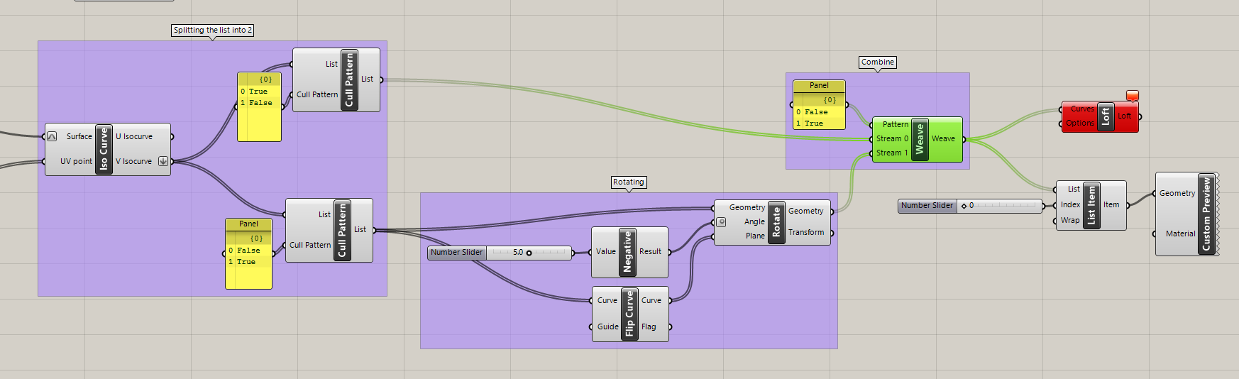

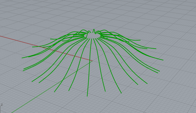

I have a list of radial aligned lines created fully in grasshopper.
I split the list in 2 lists with every 2-nth line in the other list.
I now “weave” them back together but I cant loft them…
How can I fix this?

You need to cull the first or last item in the list, then set the loft options to closed
This one worked too maybe:
I’m not sure what to do with the seam though.
