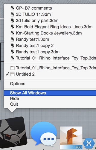

Another way to show all open Rhino files is from the dock Icon / Show All Windows.
gives me this …
