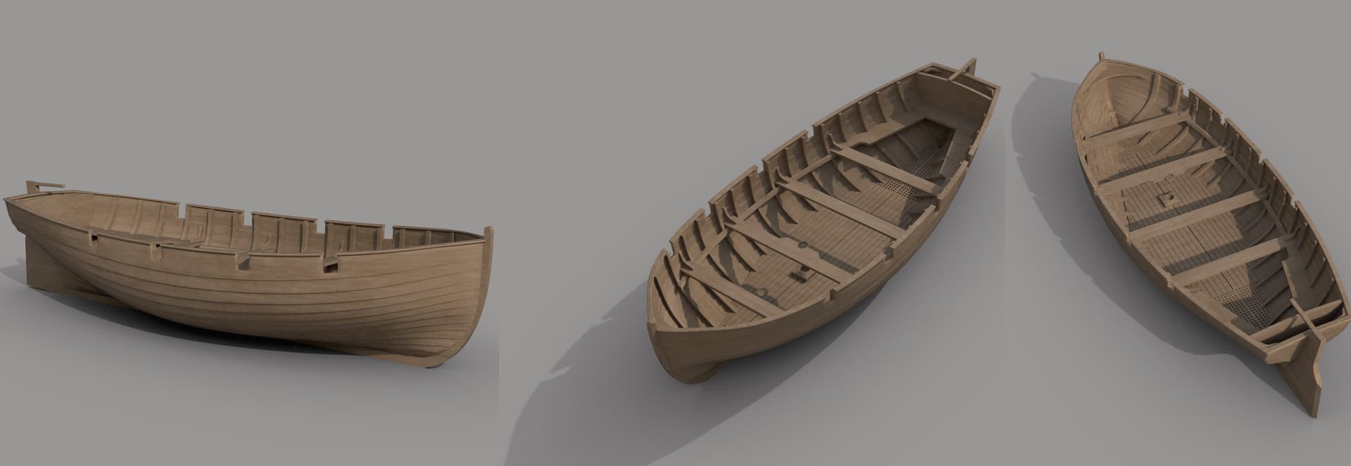

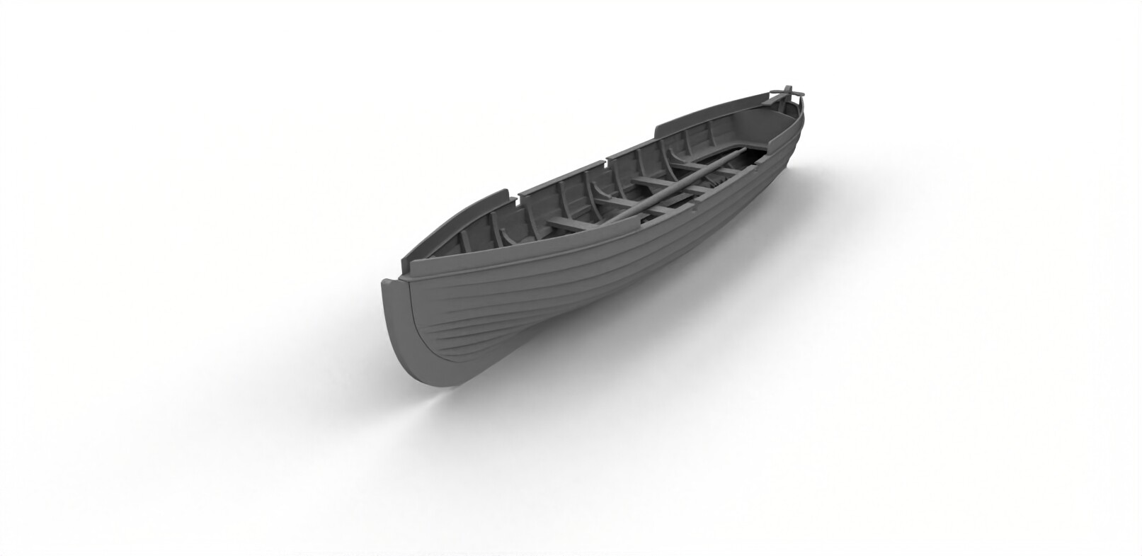

A few ship boats for 3D printing
What are these based on - drawings, photos, measurements of existing boats, creativity?
The boats are made based on original shipbuilding plans of ships from the 18th and 19th centuries
these are really cool!!
would love to see pics of the finished 3d printed parts!
It would be interesting to learn a bit more about the boats, and where you found the resources/data to recreate them. Very old lines plans, models, info etc?
These boats were created based on the books in the “Anatomy of the Ship” series.

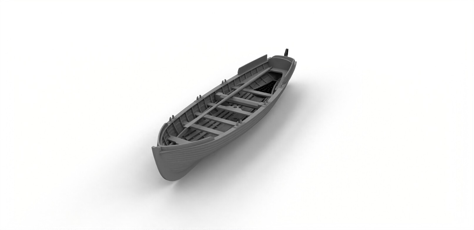

A fast render one of them.
