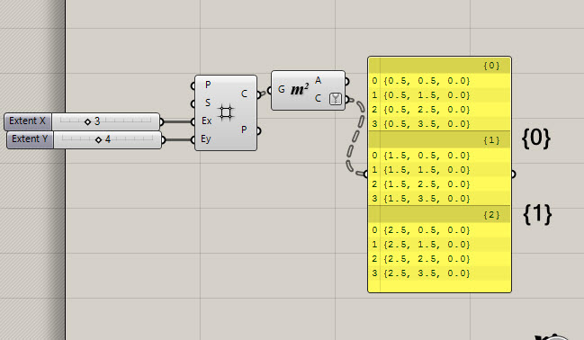

Hello Friends
How can this be done?
shift path.gh (8.8 KB)
So what would current path {0}
become in this scenario? {-1}
? {3}
You can for instance use the Path Mapper component to renumber paths.
? {3}
