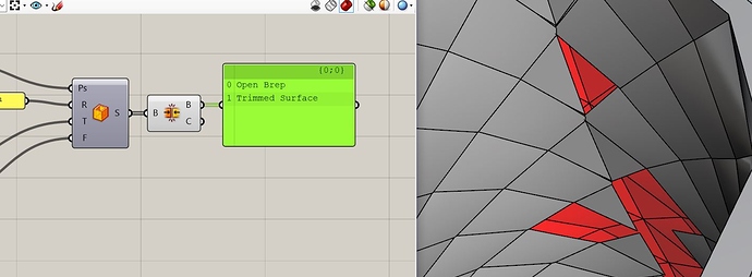

Hi there! You might notice that the Shell node isn’t completely failing. It’s creating two outputs, and one of them is valid. It’s actually just a part of the larger group. I believe this is a mistake when it comes to how the Shell node is coded, where the items are not joined after they are formed. I ran into this problem with a very faceted shape, trying to do exactly what you’re doing here and found that simply running those outputs through the “Join” node gives me exactly the output I’m looking for.
TLDR: Run the outputs of the Shell node through a Join node.
There is no mistake there, it is directly from Rhinocommon seen here: https://developer.rhino3d.com/5/api/RhinoCommon/html/M_Rhino_Geometry_Brep_CreateShell.htm
Shell has joining built into it and will output lists of breps when joining is not possible.
Good that it worked in your case but in this case it clears invalid but doesn’t resolve the actual problem of making a water tight shell. Shell is very case by case sensitive. See image, faces that were “invalid” just go missing and the facets have gaps.
Mesh is the way to go.
