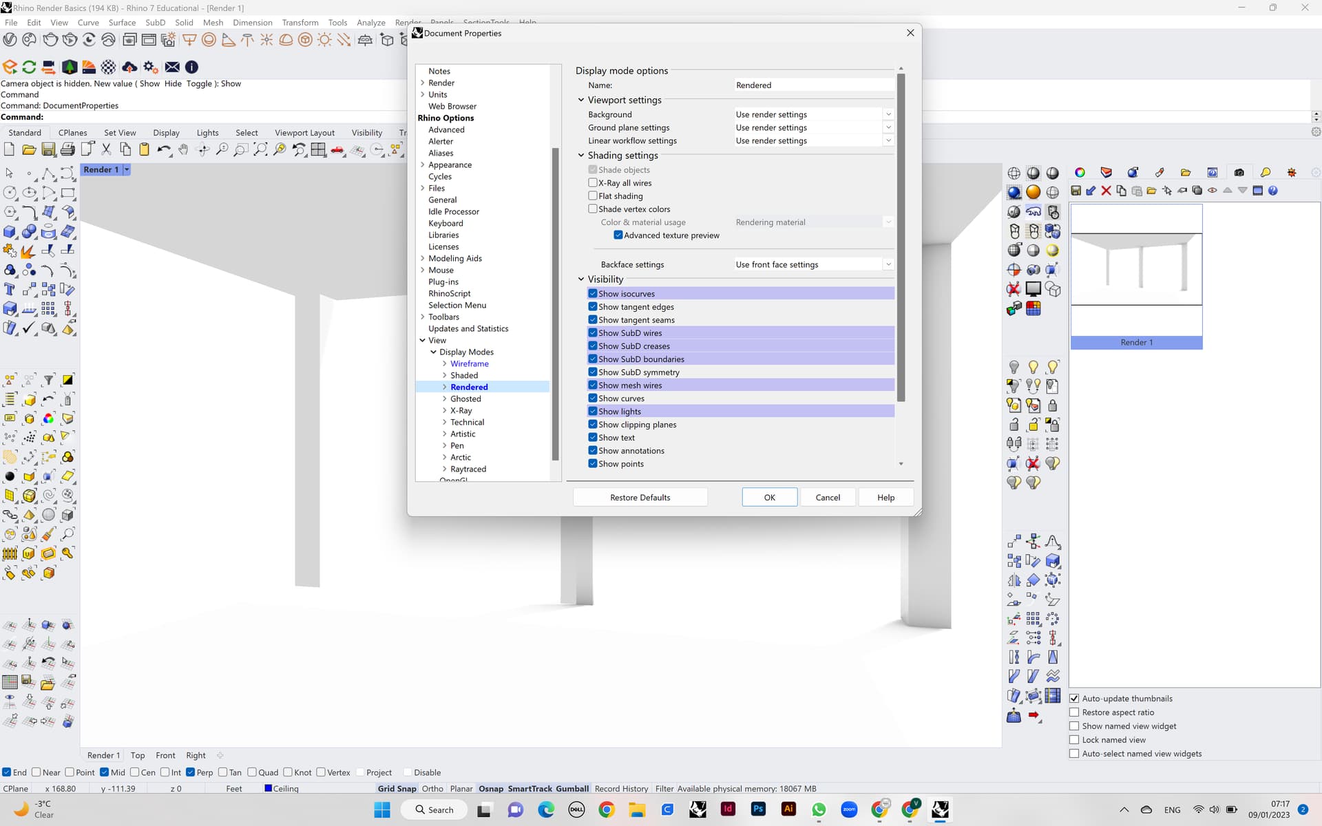

I have already turned on the sun and the shadow when I zoom into the interior of the building, it seems that the shadow does not stand out. However, if I zoom out it shows the aerial view of the building(exterior).
My goal is to make the shadow inside the building stand out not just the outside.
How to resolve this issue? Thank You.
