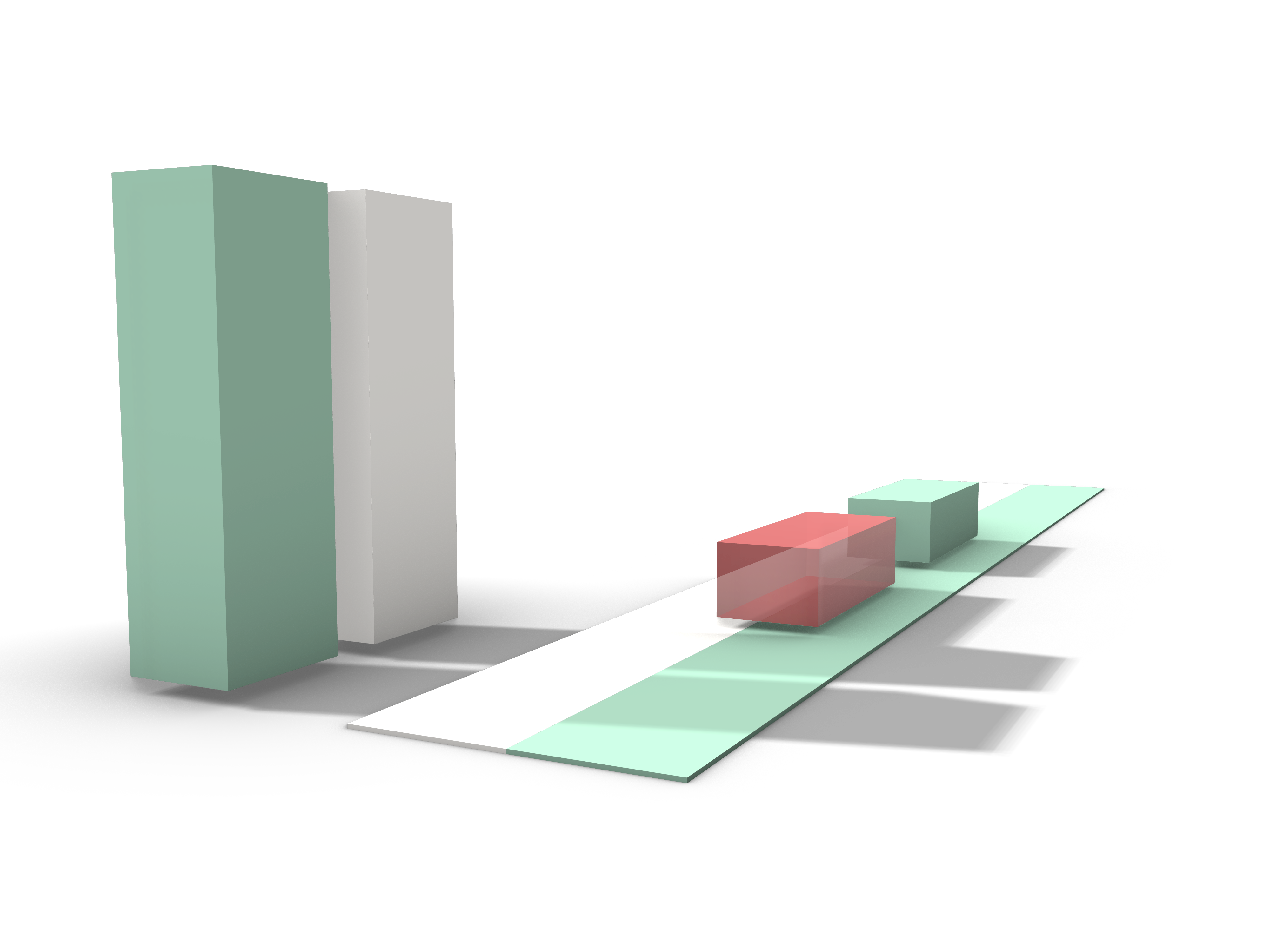

Now, users have noticed a difference in how the ground plane receives shadows.
After extensive testing, it turns out this issue is related to transparent geometry.
In this test scene, I have placed some geometry on top of the ground plane. The ground plane is set to only receive shadows, as I need a transparent background.

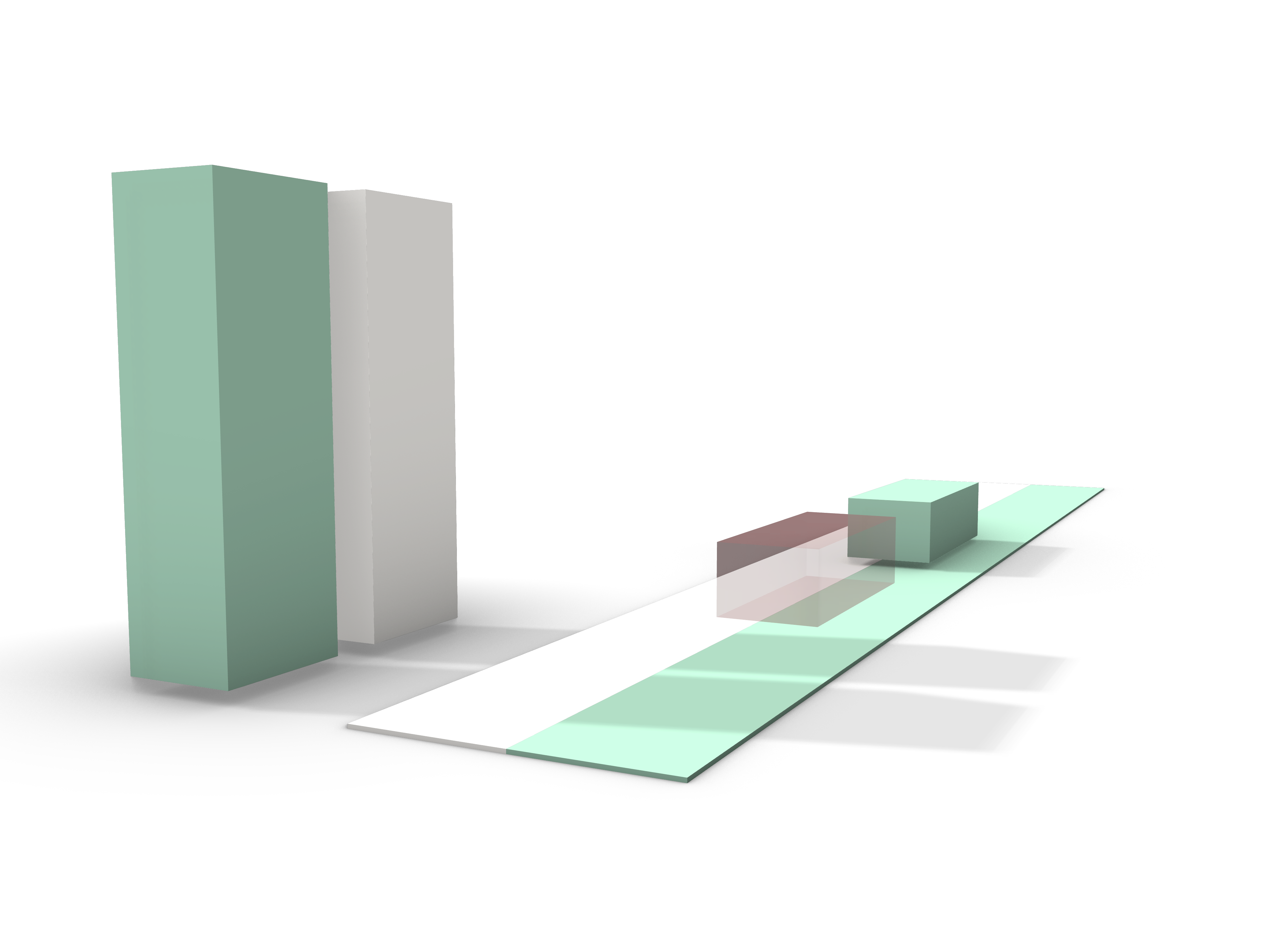

In the four images, I only change the transparency of the red box: 20%, 40%, 60%, and 80%.
Notice that the shadow appears correctly on the green surface, but the intensity on the ground plane changes depending on the transparency level of the red box.
As a result, our screen renders show varying shadow intensity based on how transparent some geometry is.
Why is this happening?

We compared the shadows in Rhino 7 and 8, and the ones in R8 are better. The issue is that they change depending on the transparent materials in the file.
One of the geometries has a transparent material that seems to be “responsible” for the shadows on the ground plane. If I change the transparency of the material on that geometry, the shadows change. If I apply another transparent material to that object, it’s the transparency of the new material that affects the shadows.
