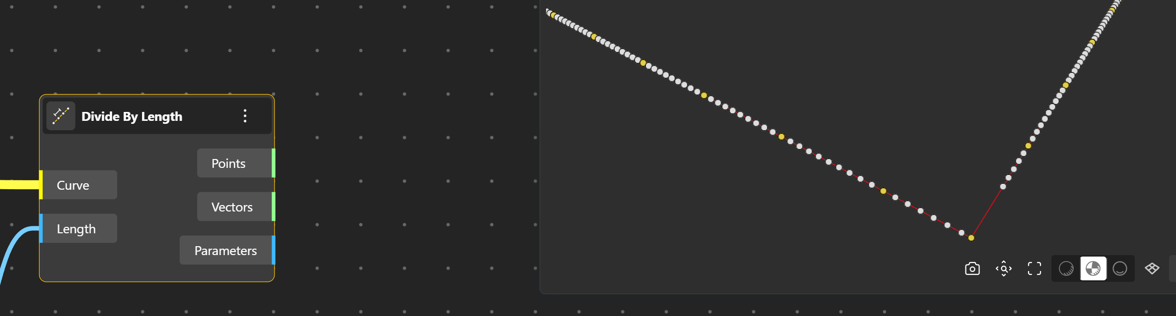

Please don’t get me wrong. This is a nice achievement but so undercooked yet.
I thought I will try to use in for my daily work and it failed at first attempt.
Please see how it divided 3000x2000 units rectangle (split into fragments) by equal length = 450.
Somehow the correct subdivision is there (yellow dots), but what is this white trash doing? And that was the first (out of >5000 operators) I have in Gh.
You can built gadgets and stuff but for serious business is no-go, unfortunately. I will be watching it closely and keeping fingers crossed for development. I want to introduce ii to my nephew as a toy (not a tool yet).
I kept working and bumped into another basic problem. There is not offset at all, whatever option I have tried:
and when Side is active, it is giving me half result, half way long
Hi Piotr, Thanks again for giving it a proper test drive and proving your point so clearly!. You are absolutely right, it is still undercooked, maybe even still in the freezer sometimes! I have used it several times myself and, yes, a few attempts did not reach the expected results… but to be fair, even in Grasshopper some scripts stubbornly refuse to behave the way we want.

You are right regarding the horrible faceting of curved volumes. That has partially been improved. To overcome it one needs to scale the object at the moment. Probably the problem will stop to exist when the units of measurement are added to the system.
As for the live feedback for the sliders - it’s in place. But to turn it on you need to go to settings and turn the toggle for ‘Live calculation’ ON. It’s working in the Editor environment only, but we will add it to the Configurator & Viewer modes also.
Btw, thanks for the feedback! If you have any more, please share, we will be happy to improve

Probably the problem is already fixed
Re: offsets
I just tried to see what your problem was.
One of the problems is probably already fixed, because I was unable to reproduce it.
However this one is still there. Now that we are aware, we will address it. Thanks a lot for bringing it up!
