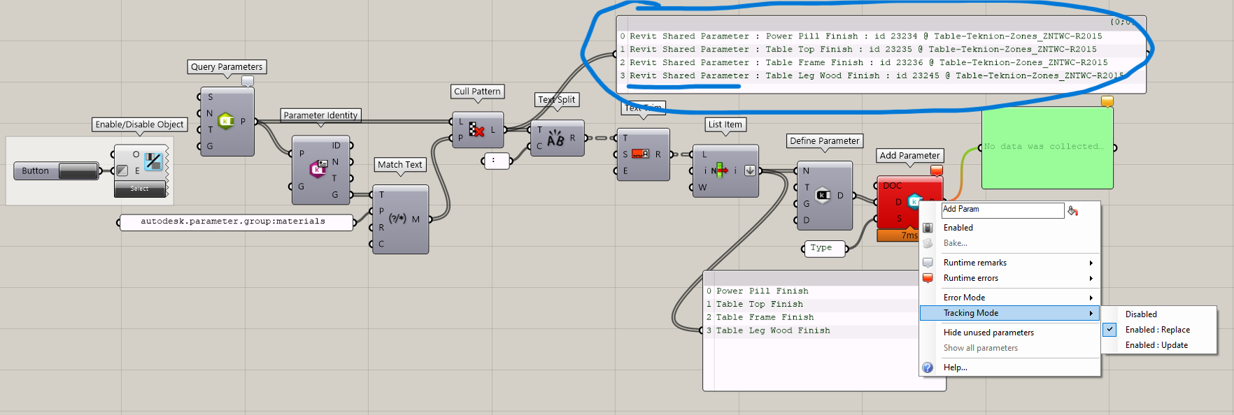

Set Family's Material Parameters to Type Parameters
I was a little confused when you said they are Shared Parameters, but I looked at my screenshot above and that was the case.
They are actually just normal family parameters though. I’m not sure why GH reported them as Shared.
Here we can see those are the shared parameters

hmm. still not converting the parameters. it’s weird that there’s no error message if it’s not accessible.
I think your parameters are not shared parameters. I hope the following will work.

Success! Thanks so much! This will save me hours.
