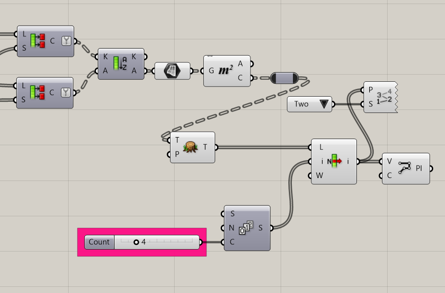

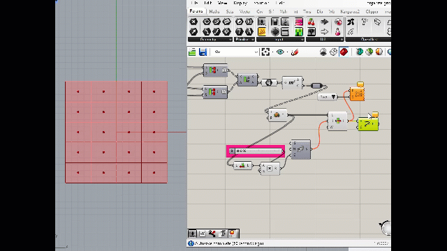

I am trying to simulate a line growing through a set of points, which can be controlled by a slider like so:
organize grid_re.gh (14.3 KB)

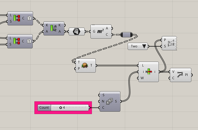

You could just use a ‘series’ component to go from one point to the other, connecting them?
organize grid_re.gh (20.3 KB)
g
If you’re looking for an automated way you could use a short piece of code to trigger a slider or right-click the slider to ‘animate’ it and export images.
You can also multiply the length of your list of points to avoid having to edit the slider range:
organize grid_re2.gh (22.6 KB)
g2
*If your list length is not going to change from 20 maybe just use addition.
