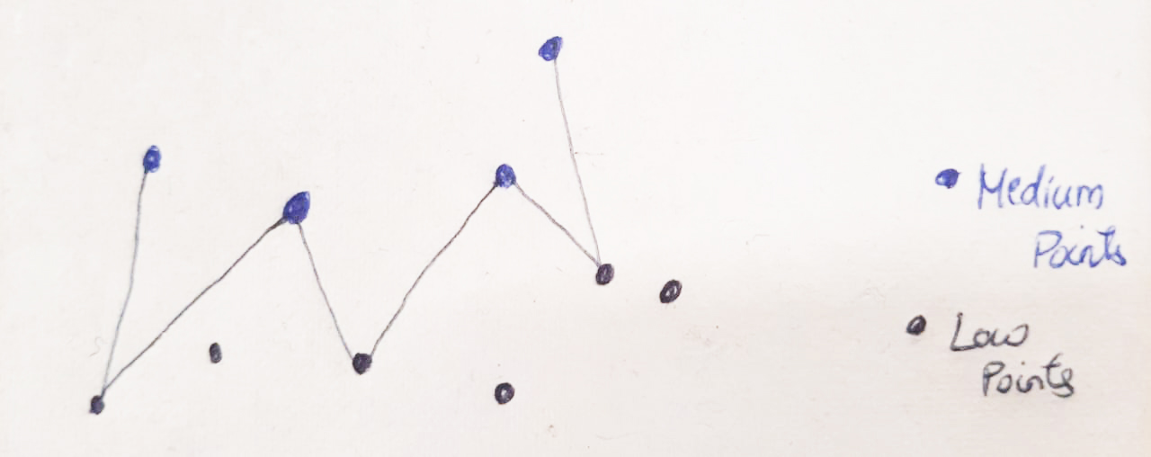

Hi guys, I wanted to know if there is a way I can select one point(low point) in between two points(medium points) and join a line in between them so it becomes medium-low-medium line.

I don’t see a pattern in the GH file that matches your image and don’t understand what you are asking.

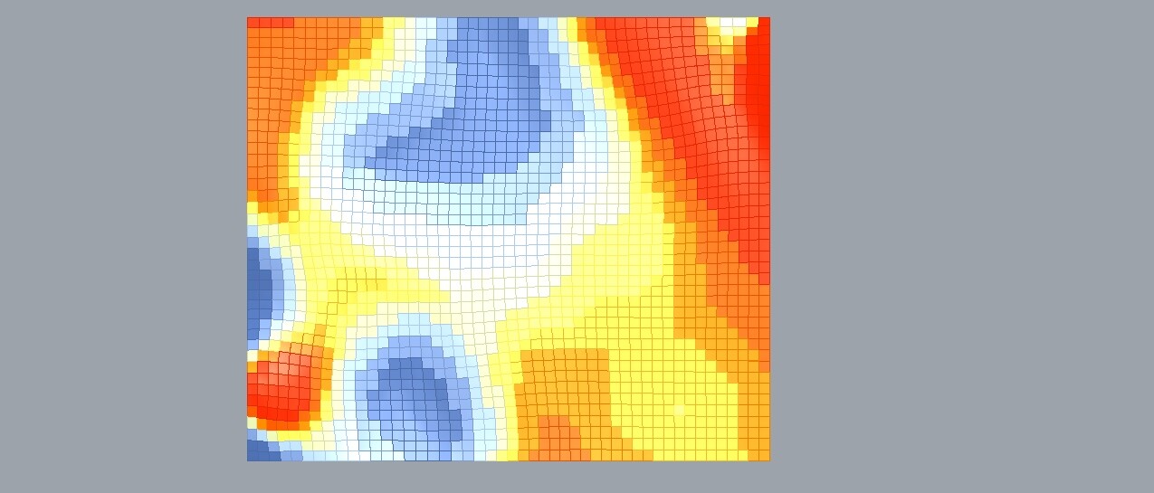

I actually didn’t know any other way to take out the individual colored surfaces from the script so :sweat_smile:

Still not sure quite what you are looking for with the points but I have some guesses and will try them out.
Here is the reworked code with the colors. do as many or few divisions as you like. I saw that you had grouped the 9 sections into 3? So why not just start with 3?
Anyways here is what I had in mind. I did not use @Joseph_Oster 's code since I wanted to try from scratch on my own. His was better most likely.
T6_F_Color_1 Ryan.gh (67.6 KB)
this is based on your sketch , not your file:
WeavePoint_001.gh (14.1 KB)
