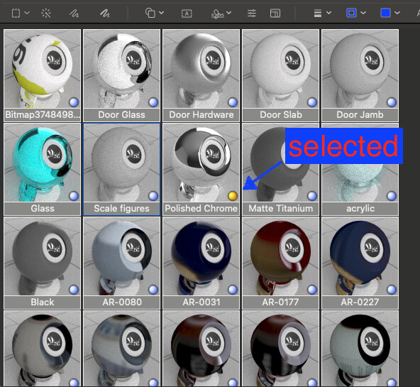

Why can it be as simple as any object selected is graphically indicated in the layer panel? Same way the material palette works thusly:
 ![image](https://global.discourse-cdn.com/mcneel/uploads/default/original/4X/e/7/0/e70d6d6c168e841ac38485eb7d2a5e58e117e950.jpeg)
<div class="post-metadata">
**Author:** ![Helvetosaur](https://sea3.discourse-cdn.com/mcneel/user_avatar/discourse.mcneel.com/helvetosaur/32/635974_2.png) [@Helvetosaur](https://discourse.mcneel.com/u/Helvetosaur)\
**Post date:** [April 16, 2025, 4:20pm UTC](https://discourse.mcneel.com/t/select-layer-on-which-object-is-on/45815/20 "2025-04-16T16:20:13Z")
</div>
Because it takes a lot of graphics and cpu resources to constantly update the panel which could result in significant slowdowns.
