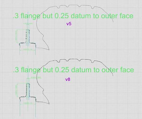

what setting fixes the quality of this ?
Its a shock to the system, having been working on this in V5, open file in V8 and its like a fine black fishing line with black ants running along it !
its a blotchy mess.
Cheers
Steve

I believe that is this bug:
RH-83262 Curves are thickening when zooming out
Can you send that curve?
nvm, I see the curve in the other thread, thanks, I’ve added this thread.
here again anyway.
Steve
I’ve already included the file in the YT. I see this with polylines having many short segments. For example, if you changedegree to degree 2 or higher, this issue will disappear.

also I am doing ChangeDegree for everything I create that is projected to mesh, but will this bite me in the bum later on , or is degree2 going to allow me to do everything I do with the default curves I draw with the Curve Interpolate Points tool I use, as well as the curves I get from projections to mesh. With the latter I use divide (usually 30) then place lines or circles through the points to get sections I can work with ?

you can always go back to degree 1, using SimplifyCrv
YT: YouTrack, our bug tracking system
so deg2 is a better curve pedigree versus mongrel !! than deg1, I didnt know what the projections were,
and YT is YouTrack, which I want aware of, BR bug Report would have been undersstood !
Steve
no, degree 2 is not ‘better’ than degree 1, it just happens to be a stupid workaround for this particular issue, and probably has to do with how line segments are optimized. But @stevebaer knows a lot more about this.
