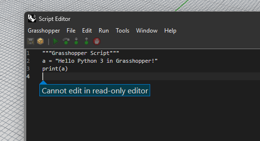

Hi @eirannejad
in Rh8.20, nothing happens when i try to apply the templates in the script editor.
I get the popup if i want to replace existing code, i hit yes, and then nothing happens.
Hi @eirannejad
Edit 2: adding a new component from scratch solved the problem.
Uh oh. Will look into this ASAP
RH-88285 Templates in GH Script do not work and leave script in Readonly
